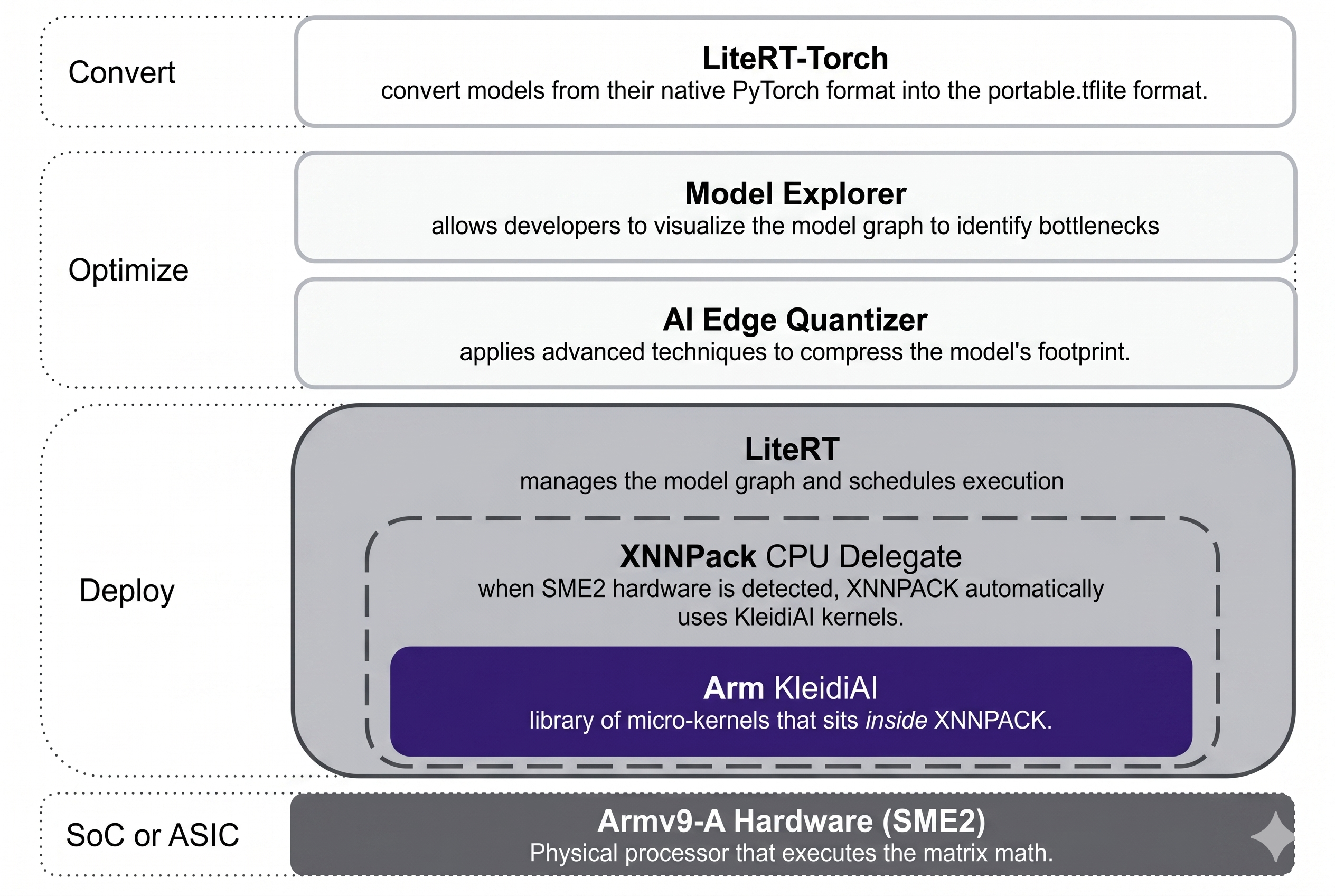

By using a diffusion-based model as the optimization target, we demonstrate a complete end-to-end path with the Google AI Edge software stack. As shown below, this synergy provides a streamlined Convert → Optimize → Deploy pipeline.
Flow diagram showing the Convert > Optimize > Deploy pipeline model
Given the KleidiAI optimizations are embedded directly into XNNPACK, developers gain specialized AI acceleration automatically. There is no need to write low-level assembly or custom hardware code; the stack handles the "translation" from high-level model to silicon-optimized execution.

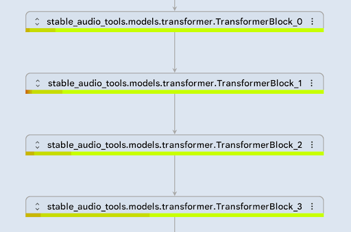

With Google’s Model Explorer, developers can now visualize the entire model graph. The new node data overlay plugin allows us to see exactly which operators are most compute-intensive or as shown below which are "quantization-safe". This visual verification ensures we only target layers where moving to INT8 won't degrade audio output quality.
For example, to improve the inference efficiency of the diffusion step, we applied dynamic INT8 quantization to the DiT (Diffusion Transformers) submodule:
Median difference ratio error reported for each DiT transformer block.
As shown in the screenshot above, all layers in the DiT submodule are green, indicating low error values within the DiT transformer (FP32 vs. FP32+INT8). Therefore, we expect the dynamically quantized INT8 DiT submodule to achieve quality comparable to FP32.

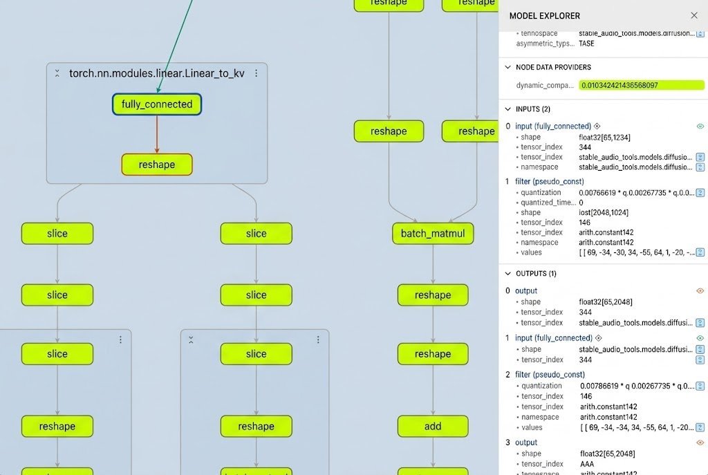

Fully connected layer with INT8 dynamic quantization. The error rate, reported under “NODE DATA PROVIDERS,” is approximately 1%.

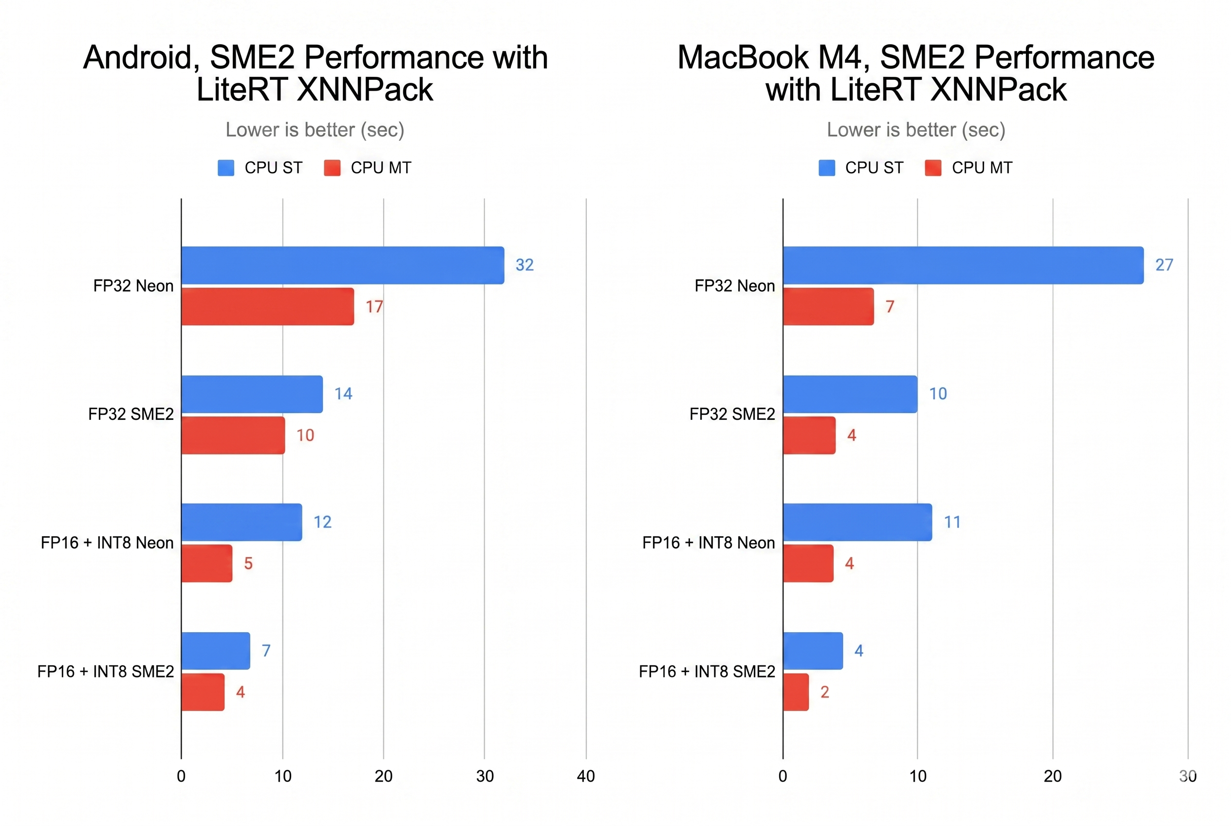

We now take our quantized fp16/int8 model from the prior section and benchmark both CPU single threaded and multi-threaded (MT) performance with the original FP32 Stable Audio Open Small model against our KleidiAI-optimized FP16 + INT8 model on an SME2-based Android device and on an Apple MacBook with M4.
  • Speed: We saw over 2x reduction in audio generation time, from 10 seconds to just 4.3 seconds on an Apple MacBook M4 and down from 14 seconds to 6.6 seconds on an Arm SME2-based Android device with 1 thread.
  • Memory: The DiT submodel size decreased by roughly 4x, significantly lowering RAM usage during inference.
  • Quality: Crucially, the generated audio maintained perceptual parity with the FP32 version.
As shown in the bar chart above, SME2 delivers more than a 2x performance improvement over the NEON instruction set, specialized for signal processing tasks. Even with a single core, it can generate 11 seconds of audio in under 8 seconds, which is acceptable from a user-experience perspective.
