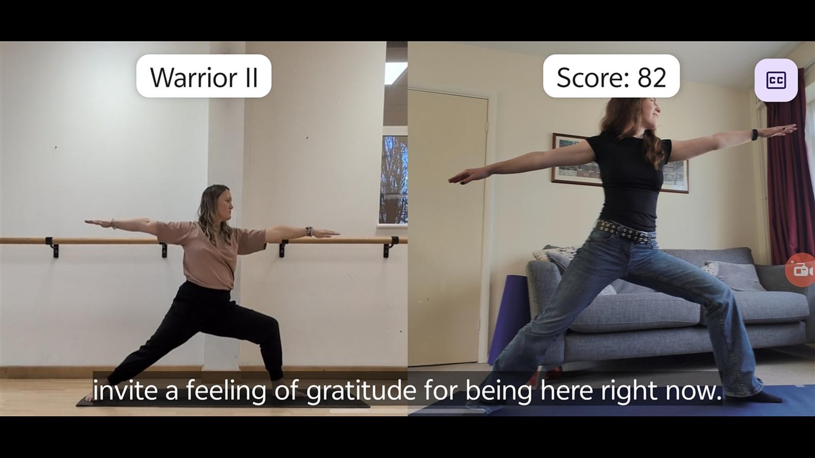

Our Yoga Tutor employs a real-time processing pipeline. This pipeline delivers immediate and context appropriate feedback. The application captures live video input from the device’s camera. and processes each frame using MediaPipe’s BlazePose model to extract 33 3D body landmarks.
These landmarks are turned into joint angles and compared to a pre-recorded instructor’s pose. Based on any deviations, a score is computed to assess user accuracy.
Using this score and the type of the previous prompt, the application decides on the next prompt type: correction, praise, transition, or general. A prompt is constructed and sent to a fine-tuned LLM, which generates feedback.
As the LLM outputs tokens, the application monitors punctuation to identify complete phrases. Each complete phrase is then sent to the Piper engine for speech synthesis. This provides immediate and continuous guidance on pose corrections.

Calculating the score
In our application, the pose score is not directly used in the LLM prompt. Instead, it drives app behavior. For example, when to trigger transitions, when to provide praise or filler comments, and how to assess user progress.
The score reflects how closely the user's pose matches the instructor's pose. It is calculated based on the angular differences between corresponding joints. Each joint angle can optionally be assigned a weight, allowing more significant joints to influence the score more heavily.
