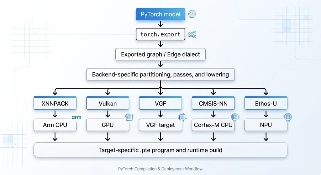

The common workflow and where it branches
High-level overview of an ExecuTorch deployment
The top part of this flow is largely shared. At each branch, the capabilities of the target hardware determine how the program is specialized.
That distinction matters. Portability here means a common PyTorch and ExecuTorch programming model. It does not mean that one .pte file or one runtime binary is optimal or valid for every target. Quantization, compilation, memory planning, linked kernels, registered delegates, and the final program can differ by device.

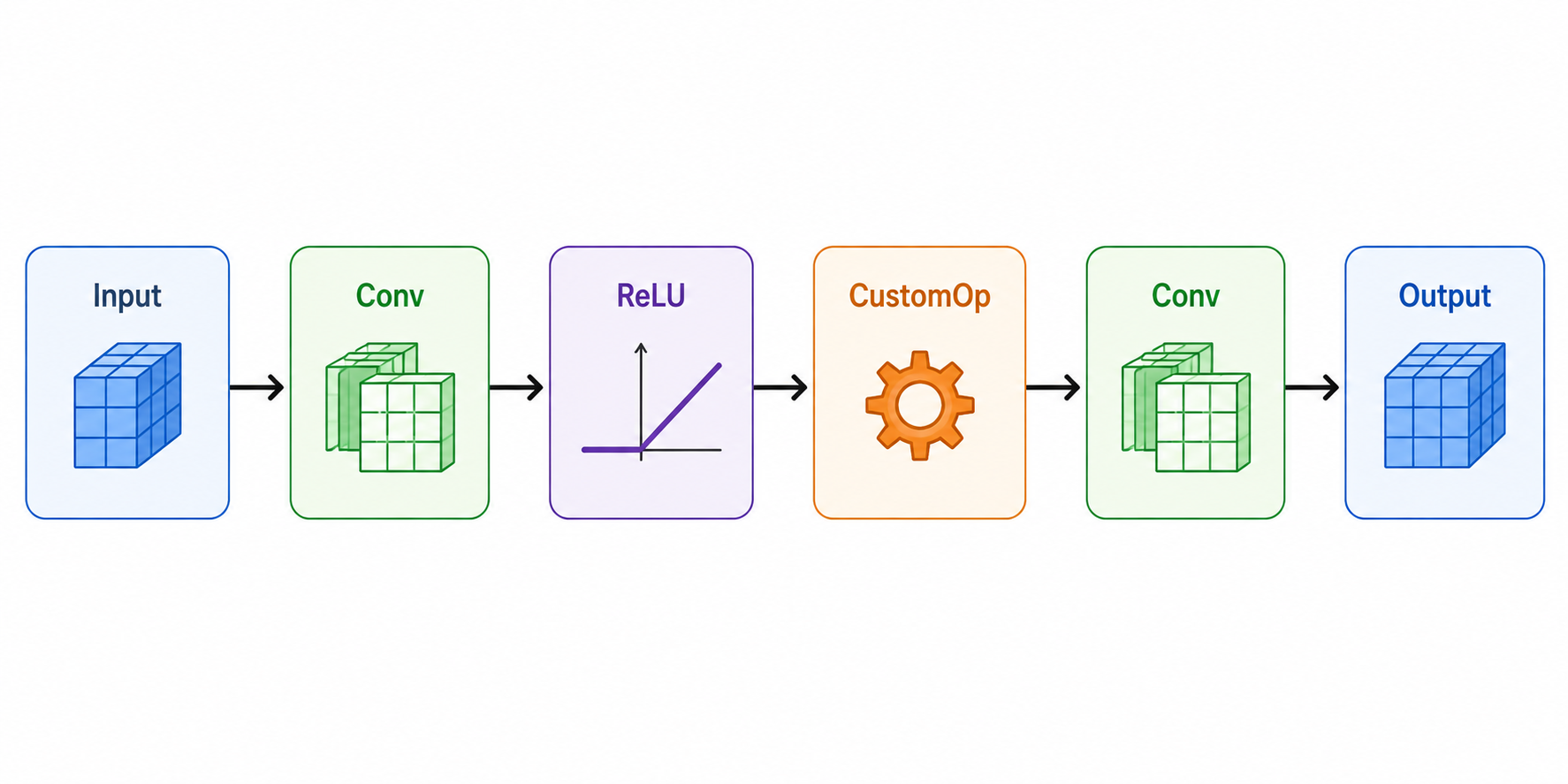

Consider a deliberately simplified graph:
Deliberately simplified graph

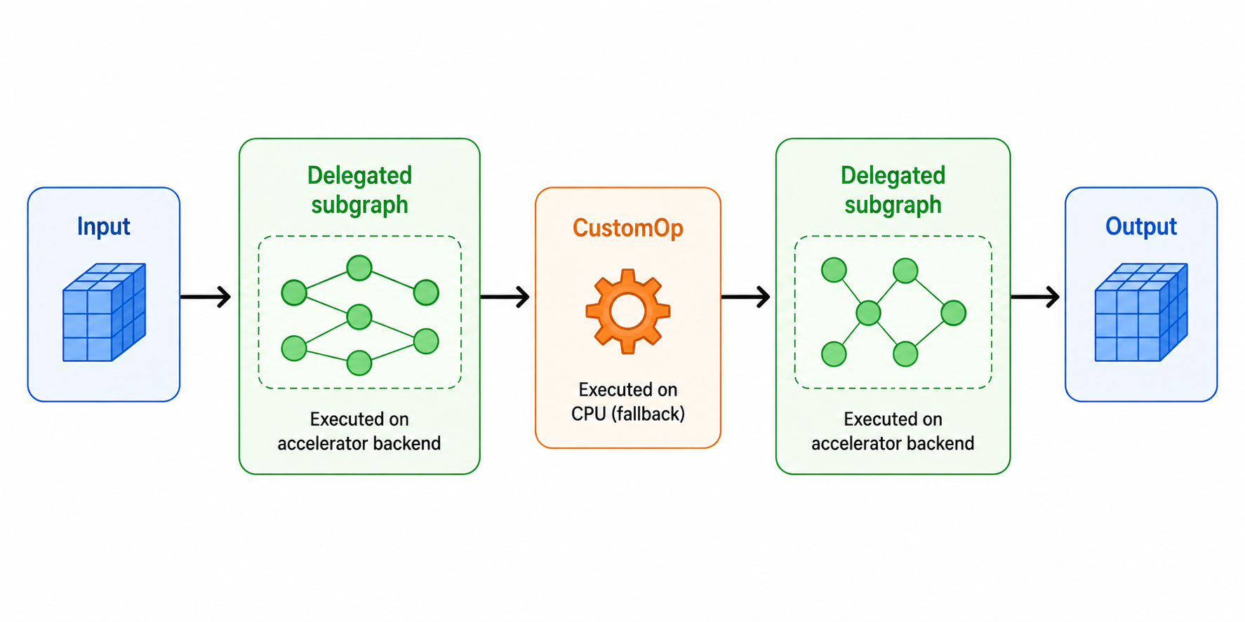

Suppose a backend supports Conv and ReLU, but not CustomOp. The exported program might become:
Exported program
This is partial delegation. It increases model coverage, but it is not free. Every delegate boundary can introduce tensor-layout conversions, synchronization, copies, or quantization and dequantization work. Delegating more operators is useful only when the resulting regions are large and efficient enough to repay their boundary costs.

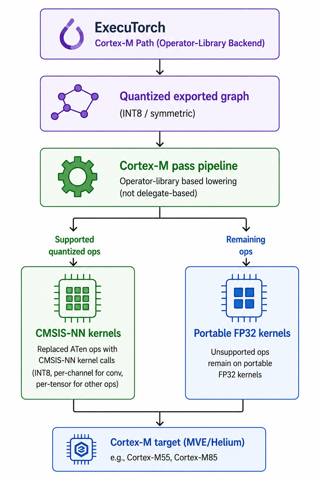

Path 4: Cortex-M CPU execution with CMSIS-NN
This path targets microcontrollers and deeply embedded devices, where memory, power, and compute resources are tightly constrained. Typical examples include IoT endpoints, sensors, wearables, and embedded control systems based on Arm Cortex-M processors.
The Cortex-M path is architecturally different from XNNPACK, Vulkan, VGF, and Ethos-U. The current ExecuTorch Cortex-M backend is an operator-library backend rather than a delegate-based backend.
After PT2E (PyTorch 2 Export) quantization, ExecuTorch runs a sequence of lowering passes over the graph. PT2E quantization prepares and converts the exported model for lower-precision execution. For supported quantized ATen operations, these passes replace the original operations with optimized CMSIS-NN kernel calls. Operations that this path does not support remain on portable FP32 kernels.
The integrated quantization path currently uses symmetric INT8. It uses per-channel quantization for convolution and per-tensor quantization for other supported operators.
This path targets memory- and power-constrained systems where every kernel and byte in the runtime matters. It is currently marked beta. The documented and validated instruction-set path is MVE, also known as Helium, on processors such as Cortex-M55 and Cortex-M85.
CMSIS-NN and Ethos-U both appear in embedded AI systems, but they solve different problems. CMSIS-NN accelerates neural-network operators on the Cortex-M CPU. It does not turn the CPU into an NPU.

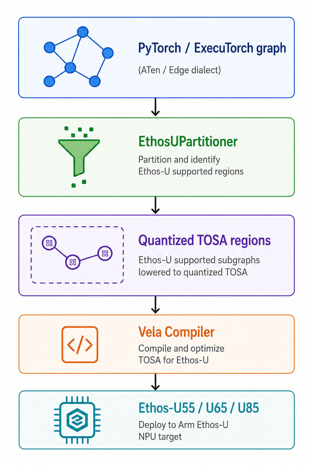

Path 5: embedded NPU execution with Ethos-U
Ethos-U is a dedicated NPU path. The EthosUPartitioner finds supported, TOSA-compatible subgraphs. The backend serializes these subgraphs to TOSA. The Vela graph compiler then produces the command stream consumed by the NPU.
Embedded NPU execution with Ethos-U
Ethos-U execution is integer-only. Operators intended for delegation must be quantized. The current primary flow using symmetric INT8 weights and asymmetric INT8 activations. Partial quantization is possible, but non-quantized operators are not delegated to Ethos-U.
This makes quantization part of partitioning. It is possible for an operator to be structurally supported but remain outside the NPU region. Its data type, parameters, or surrounding graph might not meet backend constraints.
Choose Ethos-U when the system includes an Ethos-U NPU and the workload benefits from its power- and performance-efficient quantized execution. Treat Vela configuration and memory placement as part of model optimization. On constrained systems, memory placement can be as important as the arithmetic. This includes whether weights and intermediate tensors use SRAM, flash, or external memory.
