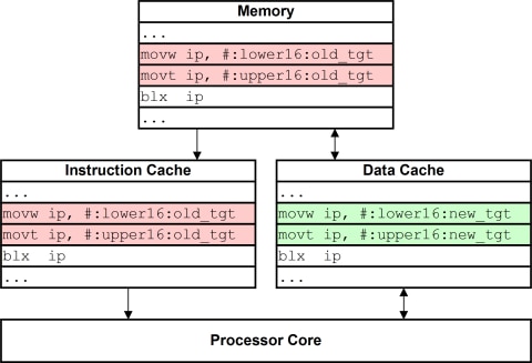

A highly simplified view of the processor before the new code is written might look like this:
Simplified view of processor before new code
In this case, the I-cache begins with the old code already loaded. This may not always be true; if the code has not been executed it is unlikely to be in the I-cache, but it is possible for code to be there even if it has not run before, and it is not practical to check this at run-time so we assume that the I-cache does contain the old code, just to be on the safe side.
The processor can only execute instructions that are in the I-cache and can only see data that are in the D-cache. Generally, it cannot directly access memory. Significantly for us, it cannot directly execute instructions that are in the D-cache and cannot programatically read or write data that are in the I-cache. Because we cannot directly write into the I-cache (or into memory), we will end up with something like this when we write out the new code:

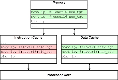

Cache after new code written
If you now try to run the code you have just written, the processor will ignore it and will simply execute the old code because it is still in the I-cache and it does not know any different. This is a real nuisance for applications (such as JIT compilers) that employ self-modifying code!

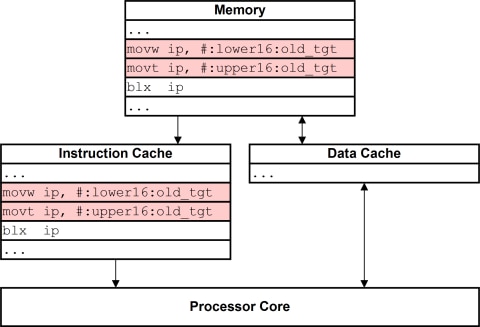

At some point in the future, the processor may decide to write out the new data from the D-cache to memory, and it may also need to re-read from memory to the I-cache, but there is not a practical way to know when it will do those things, so we have to force it. The terminology surrounding caches varies between processor architectures, so I will emphasize important terms. Currently, the data we care about in the D-cache are new, and do not match the contents of memory. These are dirty data. Unsurprisingly, to push the data out to memory, we must clean it, then wait for the write to complete. The result looks something like this:
cleaned data in cache result

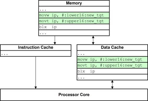

In order to execute the new instructions, we need to tell the processor that the contents of the I-cache are stale and need to be re-loaded from memory. We do this by invalidating the instructions in the I-cache. The results will look like this:
Invalidating instructions in I-cache esults
If you now attempt to run the code you have written out to memory, the instruction fetch will miss in the I-cache and the processor will have to get the new version from memory. The result is that your newly-emitted code gets executed, as you intended.
