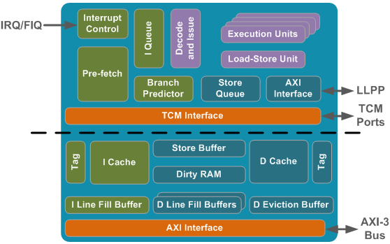

2) Tightly Coupled Memory (TCM) for performance and determinism
TCM is memory connected closely to the processor core. This memory is very fast for the processor to access. Typically it will hold interrupt service routines and data tables that need to be accessed quickly. As soon as an interrupt arrives the Cortex-R processor can switch to interrupt privilege mode and quickly start working on the interrupt code that is held there. Without TCM if the interrupt service routine code, or any data it needed to access, was not held locally in the cache then the cache would need to fetch the code from main memory and this may take many clock cycles while the processor must wait until the code and data is available. With TCM then the worst case number of cycles to start running the interrupt code is known and hence the Cortex-R processors are deterministic.
image009.pngMemory access above the dotted line the Cortex-R processor is always fast and deterministic
In a system with a Memory Management Unit then if the code or data is not available in the cache then a page table walk may be required and this could take hundred of cycles. TCM enables fast deterministic response to interrupts which makes the Cortex-R series ideal for real time systems and .

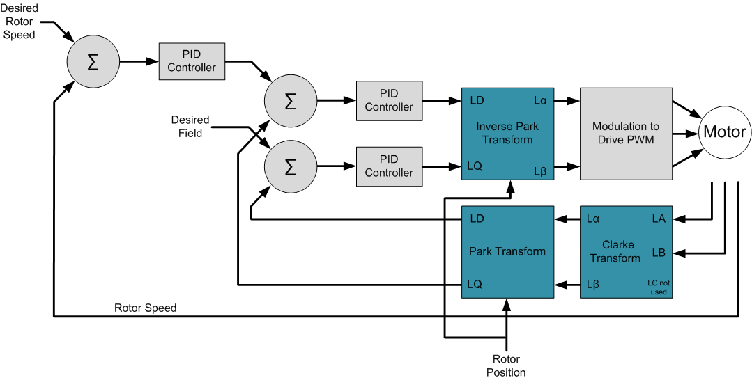

  • Controller: PID motor control, (Inverse)Park transform, (Inverse)Clarke transform...
  • Interpolation: linear and bilinear...
  • Support functions: type conversion, copy, fill...
By including these capabilities in the processor a much simpler, more cost-effective and easier to debug system can be created than by having a separate DSP. The performance and width of SIMD data processed is not as advanced as some of the very high-end standalone DSPs but in many applications, use of these capabilities can make the system more efficient and lower power.
Example motor control application where Park and Clarke transforms are handled by the SIMD/DSP capabilities through the CMSIS-DSP library

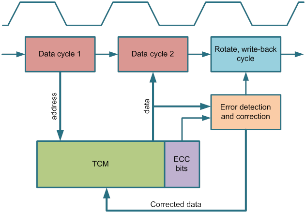

5) Error Correcting Code (ECC) generation/checking is built into the processor pipeline
ECC is a method of checking that the memory location data is correct and has not been corrupted. If a single bit error is detected then it can be automatically corrected and written back to the memory location. The memory has additional bits added and a code is generated and stored in these additional bits whenever information is written to memory. When the memory is read back the code is checked to ensure the data and code still match. This could be the case if there has been a Single Event Upset (SEU) such as radiation hitting the memory location and flipping the bit, or if there is a physical error in the memory. In the Cortex-R Series the ECC code generation and checking is done automatically and does not cause any performance impact, unless of course and error is detected. EEC is an optional feature on all of the Cortex-R Series.
Example of ECC on TCM as part of the Cortex-R Series pipeline
