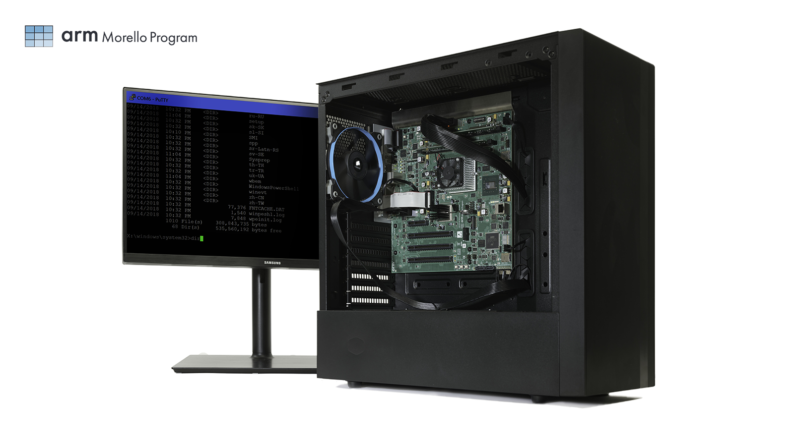

The Morello hardware technology demonstrator (or Morello evaluation board) provides a SoC implementation of Arm's prototype architecture. It expands a 64-bit Armv8-A CPU with an experimental integration of CHERI (Capability Hardware Enhanced RISC Instructions). The platform was created to enable software developers and researchers to explore the benefits and challenges of the prototype architecture, providing valuable feedback to inform future development.
