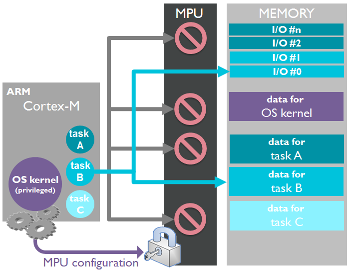

The MPU is a programmable unit inside the processor that allows privileged software to define memory access permissions and memory attributes to different regions within the 4GB memory space.  All memory access is monitored by the MPU, which can trigger a fault exception if unauthorized access is attempted.  The MPU adds robustness to embedded systems in many different ways.  It can prevent stack overflows in one task from corrupting memory belonging to another task.  It can define regions of memory where access is never allowed by instruction fetches, thus preventing any potential malicious code from being executed from those regions.  It can secure regions of RAM/SRAM from accidental corruption by defining those regions as read-only.  It can also define regions of memory as “shareable” when multiple masters in the system have access to that region.  By being shareable, the system is required to ensure coherency for that region among its masters.
Figure 1: Example MPU usage: preventing task B from corrupting memory region belonging to OS or other tasks.

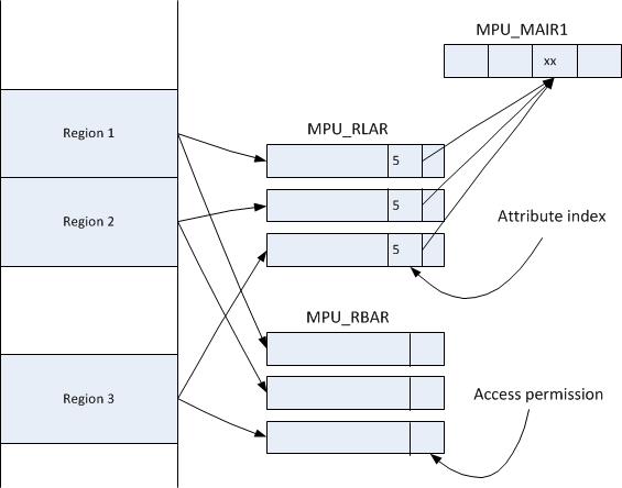

PMSAv8 MPU also brings new memory attribute indirection registers (MPU_MAIR) that make it easier for multiple regions to share the same attribute, while at the same time maintaining their own access permissions.  For example, multiple SRAM regions can have the same cache-related memory attributes, but some regions can be set to be ‘execute never’ (XN), while another can be accessible by both instruction fetches and data read/write.  The memory attribute index field in MPU_RLAR register for each region indicates which of the eight memory attributes defined in the attribute indirection register (MPU_MAIR) to use.
 Figure 3. Same memory attribute assigned to regions 1, 2, and 3.
