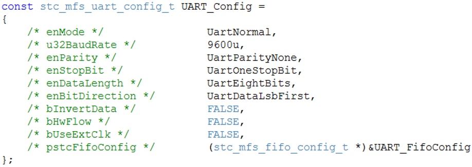

Secondly, PSoC Creator generates some supporting firmware for the peripheral. There are macros to identify the MFS block used and to make the pin connections (more on this later). Most importantly, it generates a configuration data structure for the peripheral. In this code snippet you can see how the selections from the dialog are used to populate the struct. The firmware is always neatly documented and you cannot get the struct member initialization wrong.

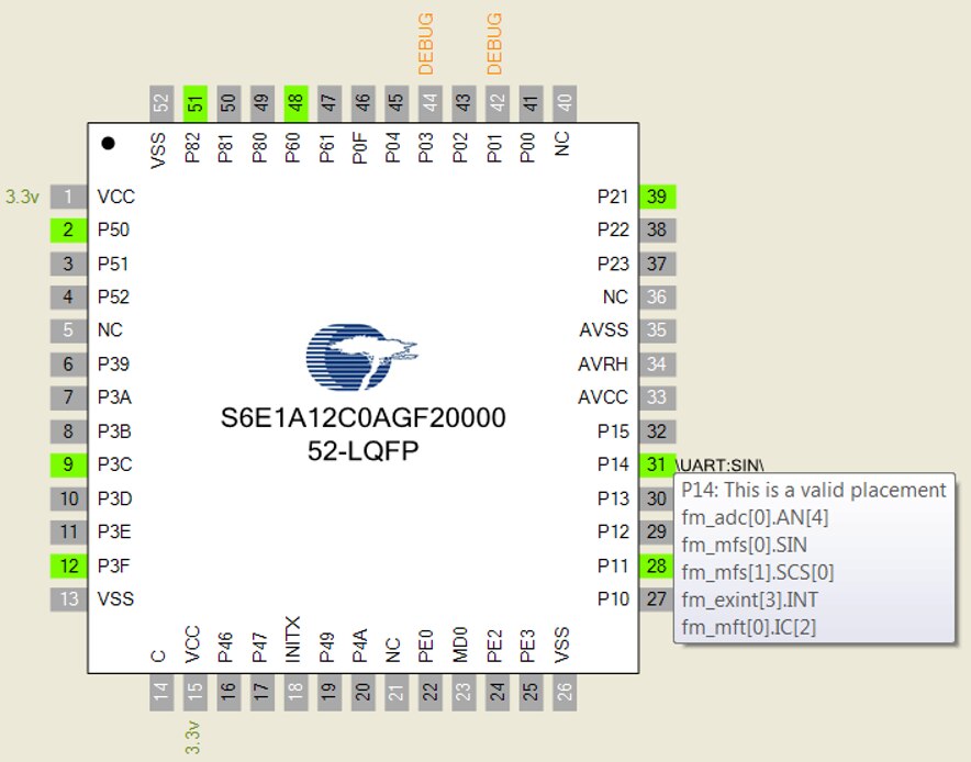

The next step is to choose the pins and the design-wide resources (CYDWR) editor makes this really simple. The editor presents all the pins and you just drag them onto the pin you want (or use a drop-down menu). The legal choices are shown in green and the tool will not let you pick an inaccessible pin. In this picture I have chosen pin 31 (aka port 3 pin 1) for the Rx pin (MFS block input).
A UART has two pins and so, as soon as one choice is made, the tool determines which MFS block to use (in this case it is block 0) and filters the available choices for the other pin. In this device the output from MFS block 0 only goes to pin 32 (port 3 pin 2) so only that pin is shown in green.

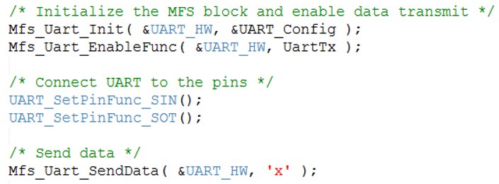

The PDL drivers have _Init() functions, in this case Mfs_Uart_Init(), which require a pointer to the MFS block and the configuration data. Both of these are generated and so the first line of C code is obvious. Note how the code would not change if you used a different MFS block - the generated code defines "UART_HW" to be MFS block 0 (UART0) so you do not have to care which actual block is used.
The pin routing macros - "SetPinFunc" - are also generated by PSoC Creator and are independent of the actual pin address. Need to move the UART to new pins? Simply change the choices in the CYDWR editor and rebuild your application. There is no need to change a single line of C code.
