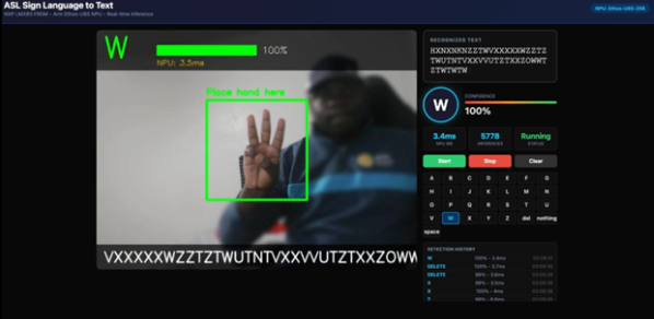

Real-time ASL recognition powered by Arm Ethos-U NPU. This open-source project implements real-time American Sign Language alphabet recognition on the NXP i.MX93 FRDM board with the Arm Ethos-U65 NPU. A USB camera captures hand signs which are classified into 29 distinct ASL alphabet characters. These include 26 letters, space, delete, and nothing with detected letters accumulating into readable text through a live web dashboard. 
Live ASL recognition dashboard with blurred background, hand detection overlay, detected letter output, and real-time inference metrics.
Key implementation highlights 
  • Ethos-U NPU acceleration: A CNN classification model runs on the Ethos-U65 NPU via the Ethos-U delegate with INT8 quantization and the Arm Vela compiler. Inference completes in about 3.5ms per frame which enables real-time classification at more than 20 FPS. 
  • 29-character ASL alphabet with temporal filtering: The system recognizes all 26 ASL alphabet letters and 3 control characters through CNN-based image classification. A–Z appends letters to the text output, space inserts a  space, delete removes the last character, and nothing indicates that no action or hand is present). 
  • Privacy-first architecture: All video processing occurs on-device. No frames are transmitted externally. The system applies a Gaussian blur to the full camera frame except the hand region-of-interest. Faces and surroundings are never visible, including on the live dashboard. 
  • Live video dashboard: The responsive web interface includes an MJPEG video feed with a blurred background and a sharp ROI box with a detection overlay, real-time text accumulation, alphabet grid highlighting the active letter, and emoji-annotated terminal output . You can access the dashboard from any browser on the local network. 

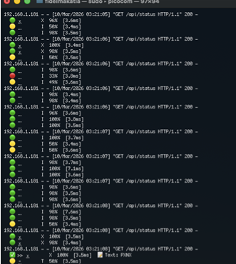

Terminal output showing real-time ASL inference logs with confidence scores, response times, and API status messages from the embedded system.

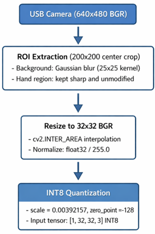

Image preprocessing 
Diagram of the ASL image preprocessing pipeline showing USB camera input, ROI extraction with Gaussian blur, image resizing to 32 × 32 BGR, and INT8 quantization before inference.
The model was trained with OpenCV cv2.imread(), which reads images in BGR format. The inference pipeline preserves this format. Frames from cv2.VideoCapture are used directly without converting the image to RGB. Consistent image formatting between training and inference is required for correct results. Converting to RGB before inference produces incorrect classifications. 

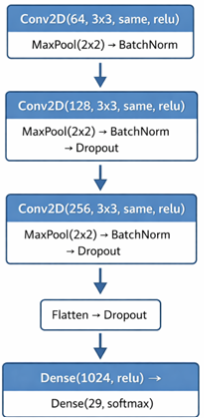

CNN model architecture 
The classification model is a standard CNN trained on the Kaggle ASL Alphabet dataset: 
Diagram of the CNN model architecture showing convolution, pooling, batch normalization, dropout, flatten, and dense layers for ASL character classification.
The model accepts 32 x 32 BGR images and outputs a 29-class softmax probability distribution. INT8 post-training quantization was performed from the original Keras HDF5 model. This preserves the correct BatchNorm running statistics. The model was converted with the TFLite's converter using representative dataset calibration. The quantized output is already a valid probability distribution. No additional softmax is applied during inference. 
