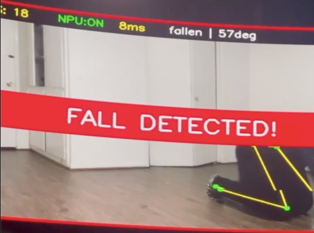

System running on NXP i.MX93 FRDM board with HDMI display showing live fall detection
Figure 1: System running on NXP i.MX93 FRDM board with HDMI display showing live fall detection.

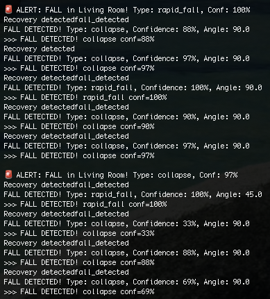

Fall detected alert with confidence score
Figure 2: Fall detected alert with confidence score

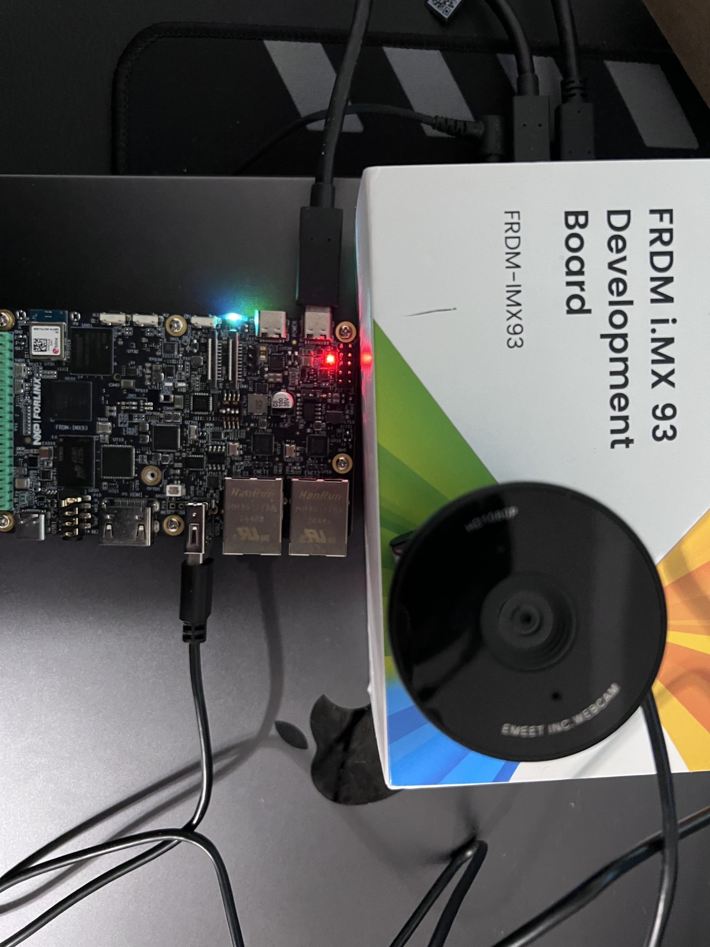

Image of FDRM i.MX 93 Development Board
Figure 4: Hardware components

Component Specification
NPU Arm Ethos-U65 (256 MAC units)
Processor Arm Cortex-A55
Board NXP i.MX93 FRDM
Camera USB Webcam (640×480)
Display HDMI Monitor (optional)
Memory 2GB RAM
Storage MicroSD or eMMC

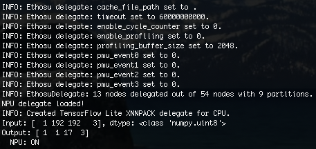

Vela compilation output showing operator delegation.
Figure 6: Vela compilation output showing operator delegation.

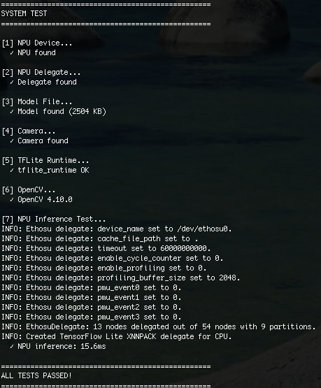

  3. Verify NPU is available: ls /dev/ethosu0.
  4. Run the system: python3 gui/fb_display.py
