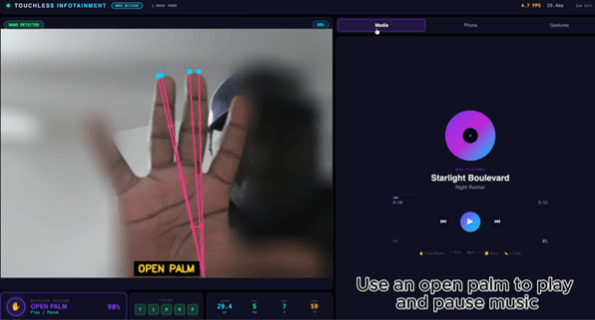

This open-source project implements a touchless infotainment HMI running on the NXP i.MX93 FRDM board with the Arm Ethos-U65 NPU. A USB camera captures hand gestures which are classified into 8 distinct commands that control media playback, phone calls, and volume through a web-based dashboard. 
Touchless infotainment system recognizing an open-palm gesture to control media playback.
Key implementation highlights 
  • Ethos-U NPU acceleration: A 2-stage pipeline runs entirely on the Ethos-U65 NPU using INT8 quantization and Arm's Vela compiler. The pipeline performs palm detection followed by 21-point landmark extraction. Combined inference completes in about 6ms which supports real-time processing at more than 30 FPS. 
  • 8-Gesture vocabulary with temporal filtering: The system recognizes 8 distinct gestures through geometric analysis of hand landmarks: 
    • Open Palm → Play or Pause 
    • Fist → Mute or Unmute 
    • Swipe Left or Right → Previous or Next Track 
    • Thumbs Up or Down → Accept or Reject Call 
    • Pinch In or Out → Volume Down or Up 
  • Privacy-focused architecture: All video processing occurs on-device. The system does not transmit video frames externally. A Gaussian blur is applied to the entire camera frame except the detected hand region. Faces and bodies are never visible, including on the live dashboard. 
  • Multiple output modes: A responsive web dashboard with live camera feed, media player, phone interface, and NPU performance metrics, all accessible from any browser on the local network. 
