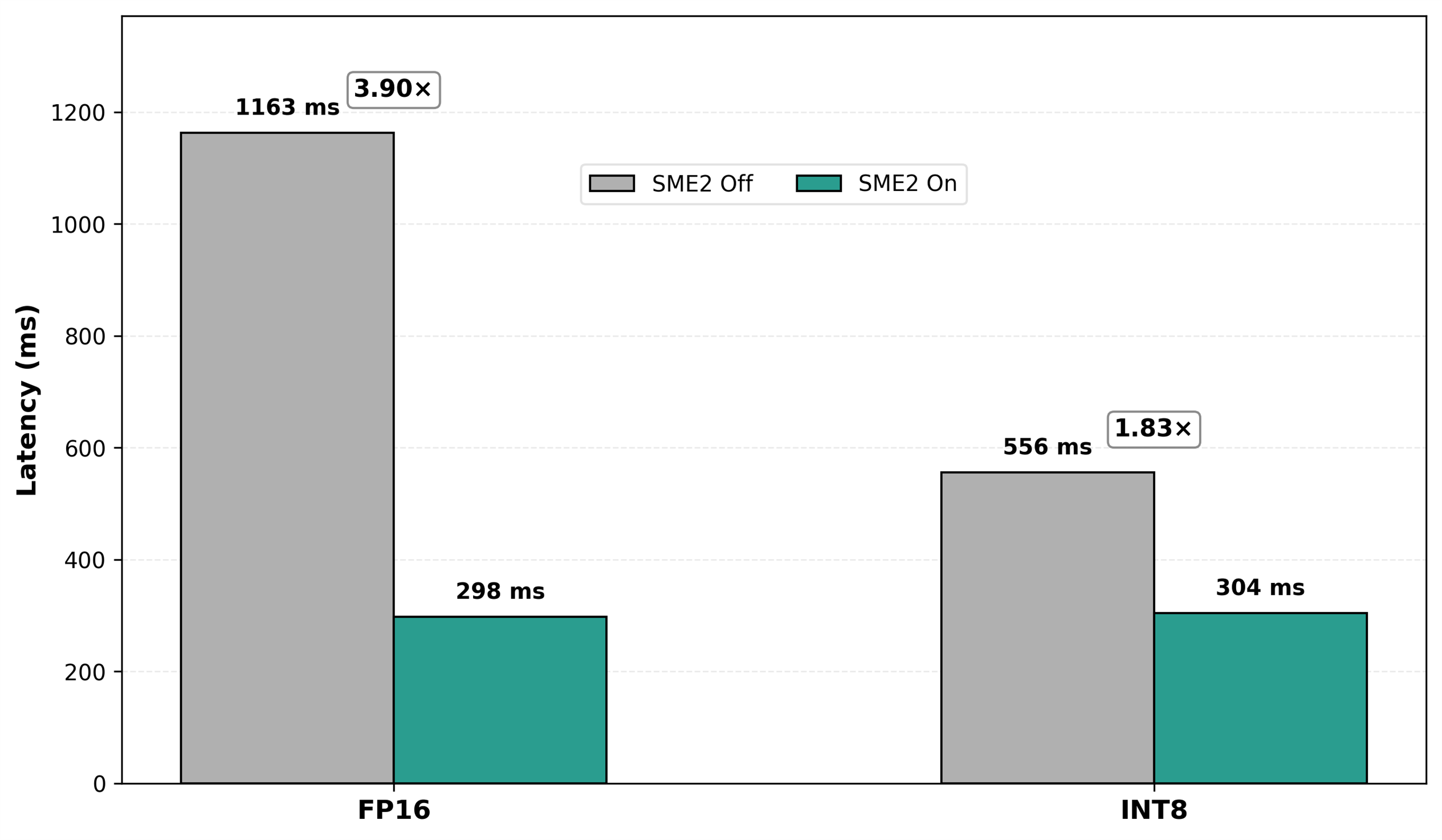

We measure the impact of SME2 on SqueezeSAM inference latency when running with ExecuTorch and XNNPACK as the backend, which uses Arm KleidiAI optimized kernels to leverage SME2 acceleration.
With SME2 enabled, both 8-bit integer (INT8) and 16-bit floating point (FP16) inference see substantial speedups (Figure 1). On a single CPU core with default power settings, INT8 latency improves by 1.83 times (from 556 ms to 304 ms), while FP16 improves by 3.9 times (from 1,163 ms to 298 ms). Without SME2, these latencies are too high for responsive interactive use; with SME2, end-to-end inference reaches the ~300 ms range on a single core, making on-device execution viable while leaving headroom for the rest of the application.
These results show that SME2 materially accelerates quantized INT8 models on the CPU. At the same time, SME2 enables FP16 to reach latency close to INT8 in this case study, which is notable because it expands the range of practical deployment options rather than replacing INT8. This gives developers more flexibility to choose the precision that best fits their accuracy and workflow requirements, particularly for precision-sensitive workloads such as image super-resolution, image matting, low-light denoising, and high dynamic range (HDR) enhancement. Without this level of FP16 acceleration, mobile deployments are often pushed toward INT8 primarily to meet latency targets, even when that means taking on a quantization workflow and the risk of accuracy degradation.
Beyond benchmark numbers, these speedups translate directly into freed CPU compute headroom. That headroom can be spent on richer experiences, such as running segmentation and enhancement in parallel (for example, denoising or HDR) while keeping the camera preview and UI responsive, or extending cutout from single images to live video cutout with subject tracking across frames, or to reduce power consumption.
Figure 1. End-to-end latency of SqueezeSAM with SME2 enabled and disabled on 1 CPU core in normal mode (default mobile power settings). INT8 improves from 556 ms to 304 ms (1.83 times). FP16 improves from 1,163 ms to 298 ms (3.90 times), and in this case study FP16 reaches latency close to INT8.
All results in this post are controlled measurements on a vivo X300 Android flagship smartphone with an SME2-enabled Arm CPU. Performance may vary across models, hardware, and specific device settings.

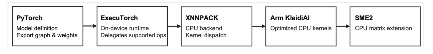

The stack: PyTorch, ExecuTorch, XNNPACK, Arm KleidiAI, and SME2
How the frameworks connect
The diagram above summarizes the CPU execution stack used in this case study. A model is defined in PyTorch, exported and run by ExecuTorch, and CPU compute is delegated to XNNPACK as the backend. XNNPACK uses Arm KleidiAI, Arm’s lightweight library of optimized CPU kernels for accelerating ML workloads on Arm CPUs. These kernels can automatically leverage SME2 on supported devices, while also providing optimized implementations for other CPU features on non-SME2 systems.
When ExecuTorch runs a model with XNNPACK delegation enabled, XNNPACK selects the appropriate kernel implementations at runtime based on the capabilities of the underlying hardware. On SME2-enabled devices, this allows the matrix-multiply computation within these operations to benefit from SME2 acceleration without any changes to the model architecture or application code. Once these operations are accelerated, other parts of the inference pipeline, such as data movement, layout conversions, and non-delegated operators, often become the next bottlenecks. This is why operator-level profiling is essential for understanding end-to-end performance.

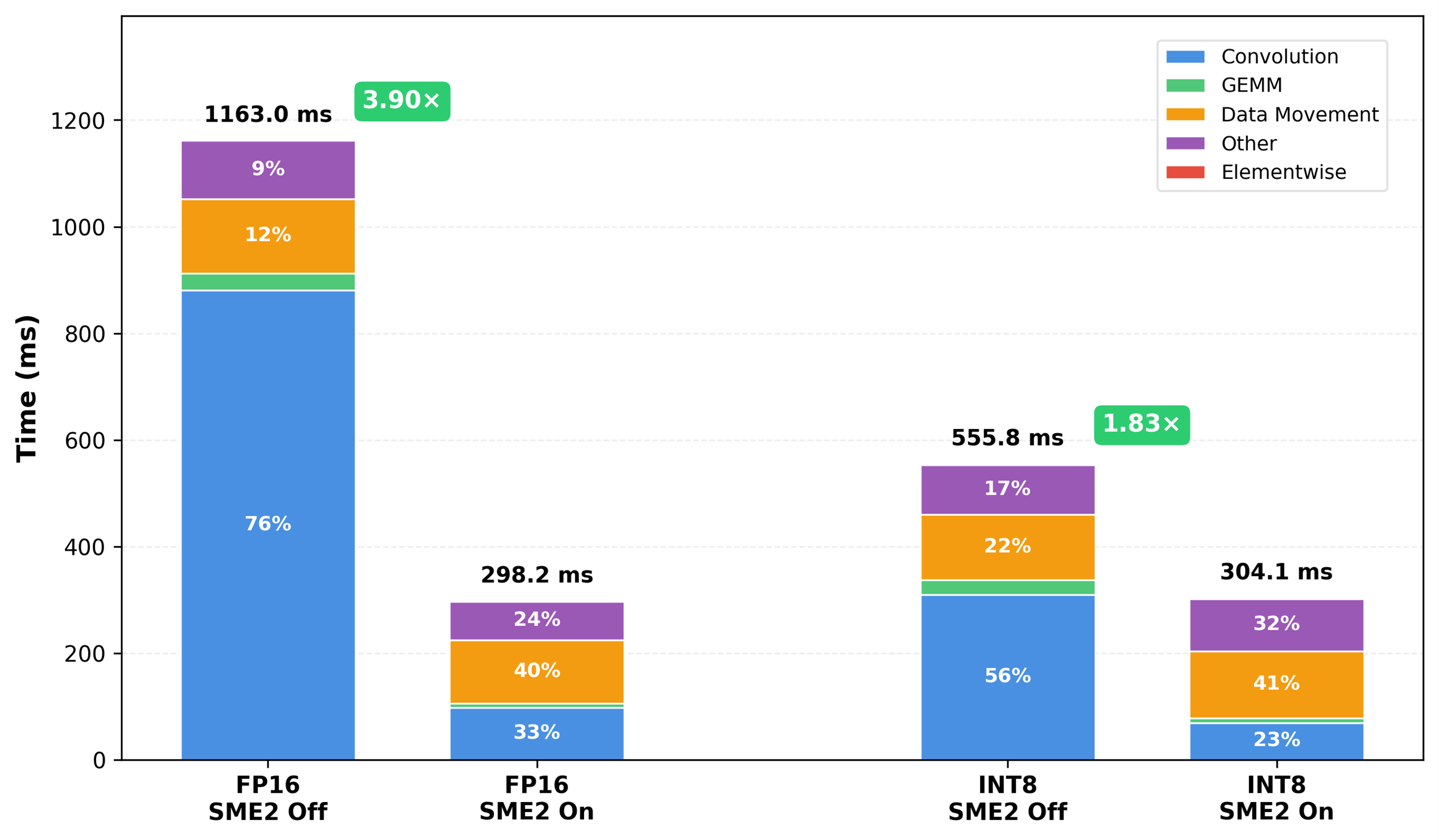

End-to-end latency tells us how much performance improves, but not why, or what to optimize next. To understand where SME2 delivers its gains and what becomes the next bottleneck, we use operator-level profiling.
We collect per-operator timing information using ETDump, a profiling tool in ExecuTorch DevTools that records execution time for individual operators during inference. This allows us to attribute end-to-end speedups to specific parts of the model, as shown in Figure 2 and Table 2.
To keep the analysis actionable, we group operators into a small set of categories that map cleanly to common model structure:
- Convolution: Conv2d layers (typically implemented using iGEMM)
- GEMM: Matmul and linear layers (attention and MLP projections)
- Elementwise: ReLU, GELU, Add, Mul, and other pointwise ops
- Data Movement: Transpose, copy, convert, reshape, and padding
- Other: Non-delegated operators and framework overhead
With this breakdown in place, we can explain where SME2 helps most and what remains once matrix compute is accelerated.
Figure 2. Operator-category breakdown (absolute time) for FP16 and INT8 with SME2 enabled and disabled on an Android smartphone (1 Arm CPU core, default mobile power settings). SME2 sharply reduces Convolution and GEMM time, and Data Movement becomes a larger share of runtime.
| Category | INT8 SME2 Off (ms) | INT8 SME2 On (ms) | INT8 Speedup | INT8 % (On) | FP16 SME2 Off (ms) | FP16 SME2 On (ms) | FP16 Speedup | FP16 % (On) |
| Convolution | 309.7 | 69.8 | 4.4× | 23.0% | 881.2 | 98.1 | 9.0× | 32.9% |
| GEMM | 27.3 | 8.1 | 3.4× | 2.7% | 31.6 | 7.6 | 4.1× | 2.6% |
| Elementwise | 2.1 | 2.2 | 1.0× | 0.7% | 1.6 | 1.7 | 0.9× | 0.6% |
| Data Movement | 123.0 | 125.8 | 1.0× | 41.4% | 139.0 | 119.1 | 1.2× | 39.9% |
| Other | 93.7 | 98.2 | 1.0× | 32.3% | 109.6 | 71.7 | 1.5× | 24.0% |
| E2E | 555.8 | 304.1 | 1.83× | - | 1,163.0 | 298.2 | 3.90× | - |
Table 2. The operator-level breakdown for INT8 and FP16, with SME2 off vs on (Android phone, one CPU core in default mobile power settings). Non-matmul operators are affected mainly by runtime variation.
