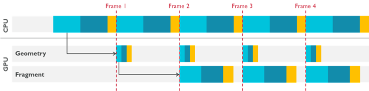

The Multiview Timeline
Before diving into the numbers, let’s discuss the theory.

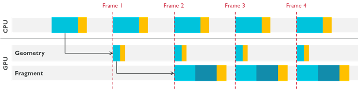

Fig. 2: Regular Stereo job scheduling timeline.
In this timeline, we can see how our CPU-GPU system is interacting in order to render a frame using regular stereo. For more in depth information on how GPU scheduling works on Mali, please see Peter Harris’ blogs.
First the CPU is working to get all the information ready, then the vertex jobs are executed and finally the fragment jobs. On this timeline the light blue are all the jobs related to the left eye, the dark blue to the right eye and the orange to the composition (rendering our two eyes side by side on a buffer).
Fig. 3: Multiview job scheduling timeline.
In comparison, this is the same frame rendered using multiview. As expected since our CPU is only sending one draw call, we are only processing once on the CPU. Also, on the GPU the vertex job is smaller since we are not running the non-multiview part of the shader twice. The fragment job, however, remains the same as we still need to evaluate each pixel of the screen one by one.

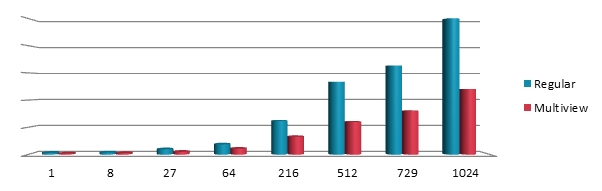

Relative CPU Time

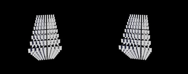

As we have seen, multiview is mainly working on the CPU by reducing the number of draw calls you need to issue in order to draw your scene. Let us consider an application where our CPU is lagging behind our GPU, or in other words is CPU bound.
Fig. 4: Scene used to measure performances.
In this application the number of cubes is changing over time, starting from one and going up to one thousand. Each of them is drawn using a different draw call - obviously we could use batching, but that’s not the scope here. As expected, the more cubes we add, the longer the frame will take to render. On the graph below, where smaller is better we have measured the relative CPU time between regular stereo (Blue) and multiview (Red). If you remember the timeline, this result was expected as multiview is halving our number of draw calls and therefore our CPU time.
Fig. 5: Relative CPU time between multiview and regular stereo. The smaller the better, with the number of cubes on the x-axis and the relative time on the y-axis.
Multiview in red, and regular stereo in blue.

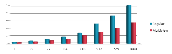

Relative GPU Time
On the GPU we are running vertex and fragment jobs. As we have seen in the timeline (Fig. 3), they are not equally affected by multiview, in fact only vertex jobs are. On Midgard and Bifrost based Mali GPUs only multiview related parts in the vertex shaders are executed for each view.
In our previous example we looked at relative CPU time, this time we have recorded the relative GPU Vertex jobs time. Again, the smaller the better, regular stereo in blue and multiview in red.
Fig. 6: Relative GPU time between multiview and regular stereo. The smaller the better, with the number of cubes on the x-axis and the relative time on the y-axis.
The savings are immediately visible on this chart as we are no longer computing most of the shader twice.

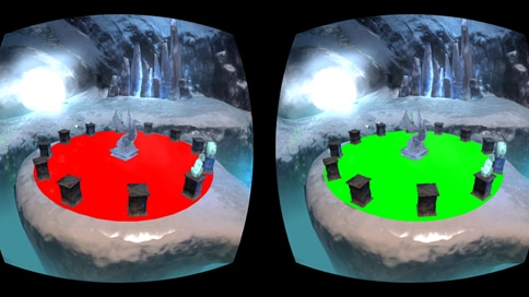

Stereo Reflections
Fig. 8: A different reflection for each eye, demonstrated here in Ice Cave VR.
Reflections are a key factor for achieving true immersion in VR, however, as for everything in VR it has to be in stereo. I won’t discuss the details of real time stereo reflections here, please see Roberto Lopez Mendez’s article Combined Reflections: Stereo Reflections in VR for that. In short, this method is based on the use of a secondary camera rendering a mirrored version of the scene. Multiview can help us achieve the stereo reflection at little more than the cost of a regular reflection, thus making real time reflections viable in mobile VR.
