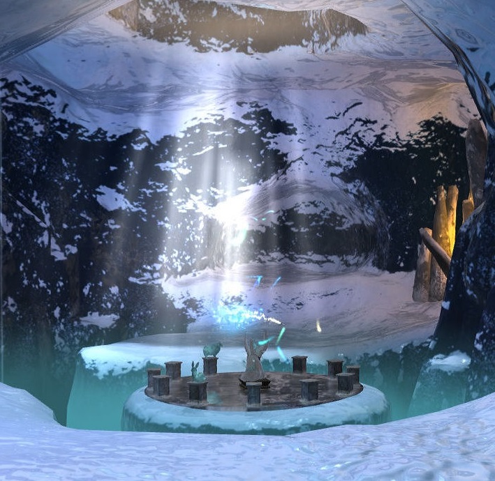

Ice Cave, the latest demo from ARM Mali Ecosystem, has been shown with great success this year in such major events as GDC, Unite Europe, and Unite Boston. The demo has been developed in Unity and aims to demonstrate that it is possible to render high visual quality content on current mobile devices. A number of highly optimized special effects were developed in-house, specifically for this demo, some of which are based on completely new techniques, for example the rendering of shadows and refractions based on local cubemaps.
Figure 1 View of the cave from the entrance in the Ice Cave demo.
