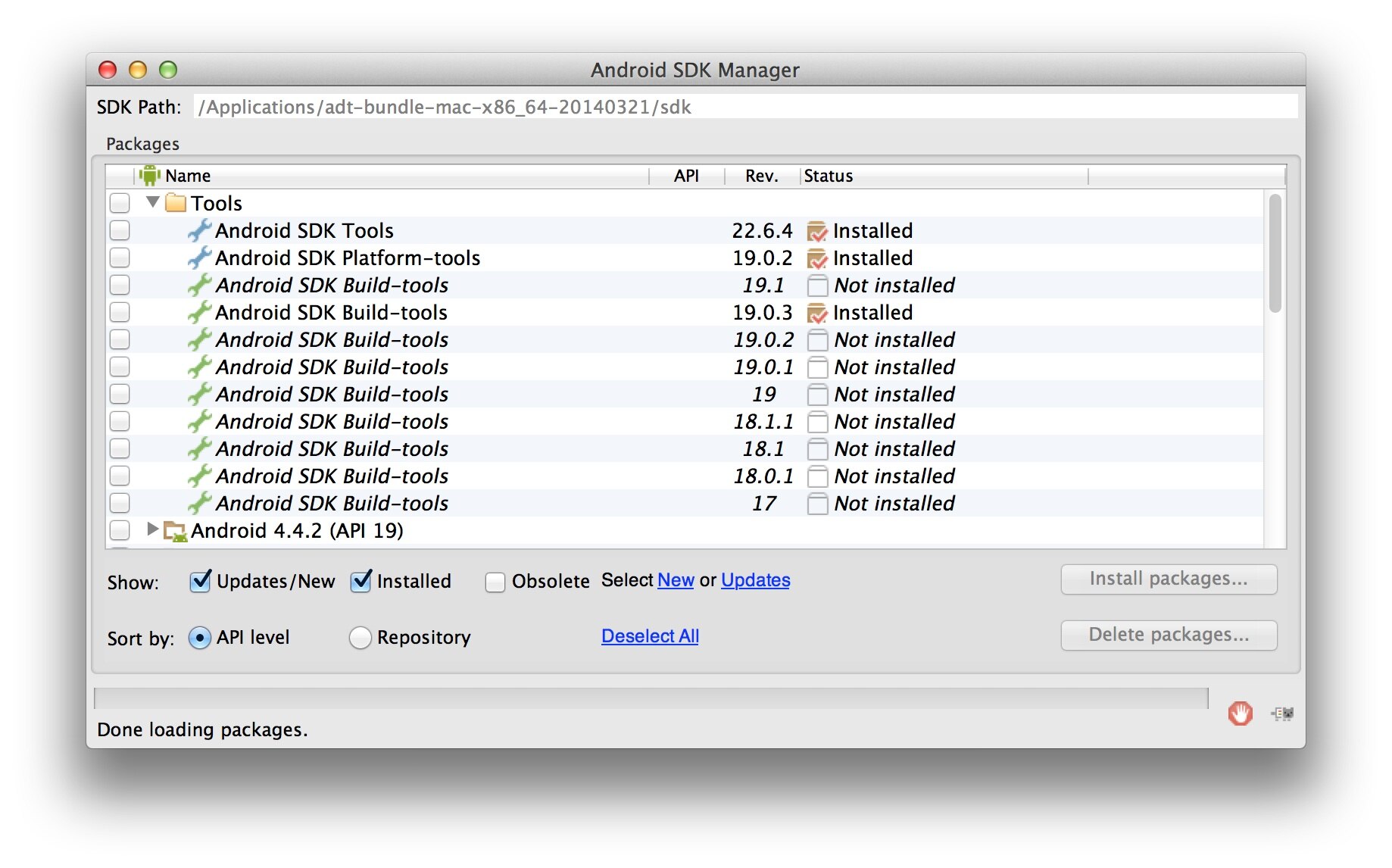

You can Launch the Android SDK Manager from Eclipse in the “Window” menu or via the command line by typing:
> android
From there, you can update your current SDK, install older APIs, build-tools, platform tools and in “Extras”, the Android Support Library for compatibility with older APIs.

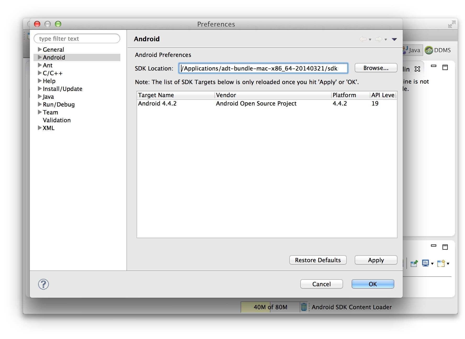

When you run Eclipse (ADT) for the first time or change versions, you may have to tell it where to find the SDK. The Preferences dialog box is found on Macs via the ADT->Preferences menu, sub heading Android.

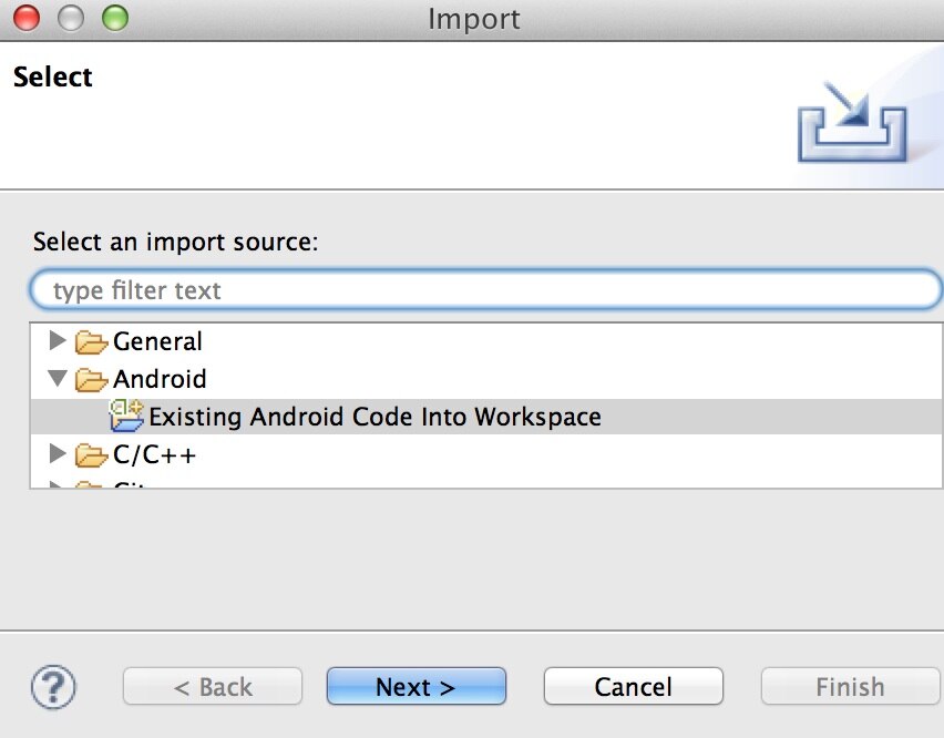

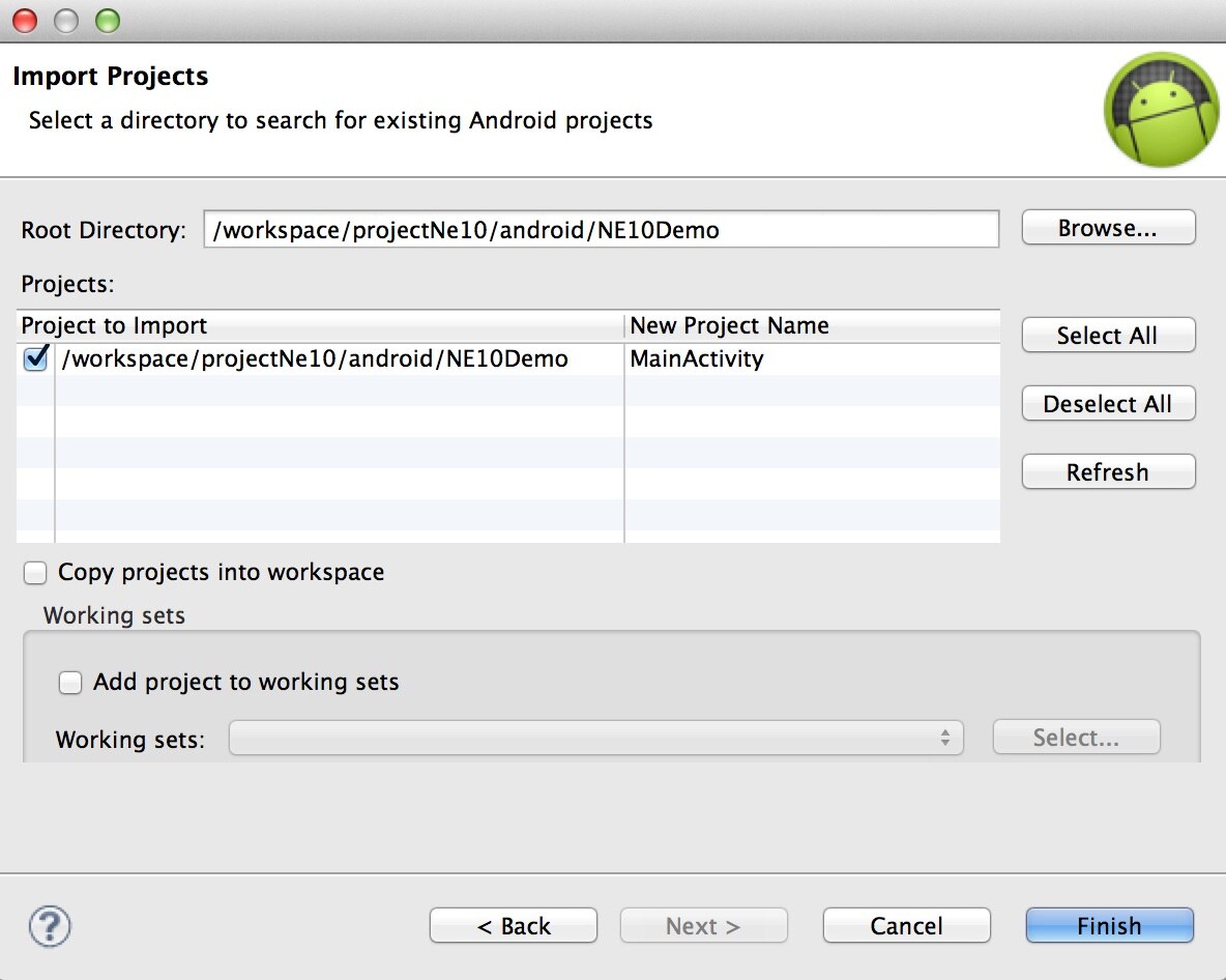

That make install line will copy libNE10_test_demo.so to your /workspace/projectNe10/android/NE10Demo equivalent. Now you can go to the File->Import menu in Eclipse and import an existing Android code base in to your workspace.
If all goes well, you should be able to connect your ARM based Android Device (in my case, a Nexus 5 running Android 4.4.4 to match the current SDK at the time of this writing) and run this app from the Run menu as an Android app. As a sanity check, you should run adb devices from the command line to verify you can see your device. This app will iterate through every function in the ProjectNe10 library with both C and NEON implementations. One of the implementations should be faster. I’ll give you a hint. It is the NEON implementation.

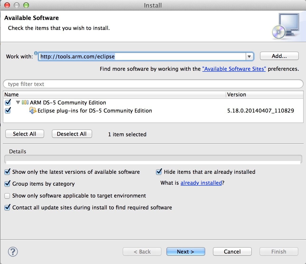

Start Eclipse and go to the menu Help->Install New Software.... Click on “Add...”, and paste http://tools.arm.com/eclipse in the location text box, then click OK. Select ARM DS-5 Community Edition, as shown on the screenshot below, and click Next. Eclipse will compute the dependencies of the DS-5 CE plug-ins.
Click Next again. Read the license agreements and if you accept, hit Finish. After the install is complete, ADT will ask you to reload.

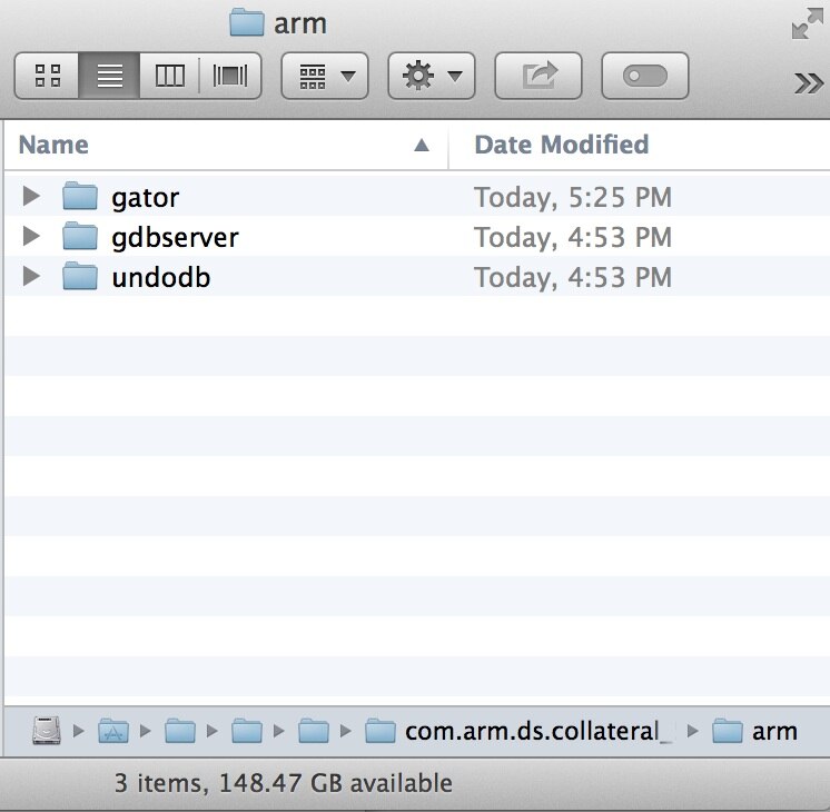

First, build gatord. Go to the menu Help->ARM Extras… this will open up a folder with several goodies in it.
I’m going to build this from the command line so fire up your favorite terminal and cd in to this directory. The easiest way in the Mac terminal app is to type “cd ” and dragging the gator folder in to the terminal window. OS X will fill in the path, then:

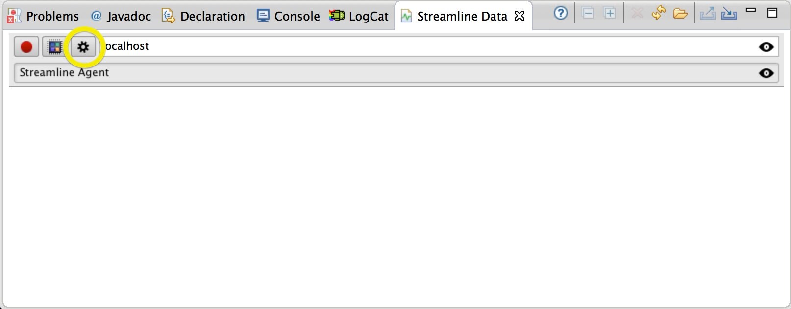

The rest is pretty straight forward. Go to the Window->Show View->Other…->DS-5->ARM Streamline Data
Click on the gear button

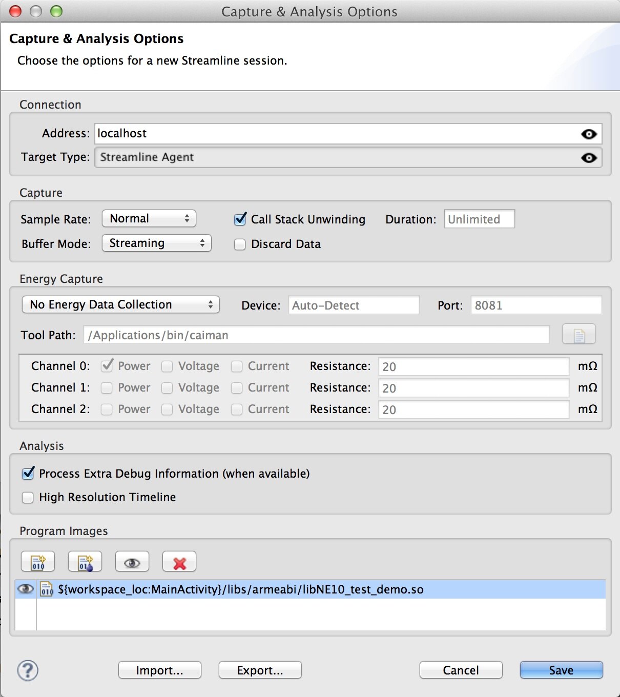

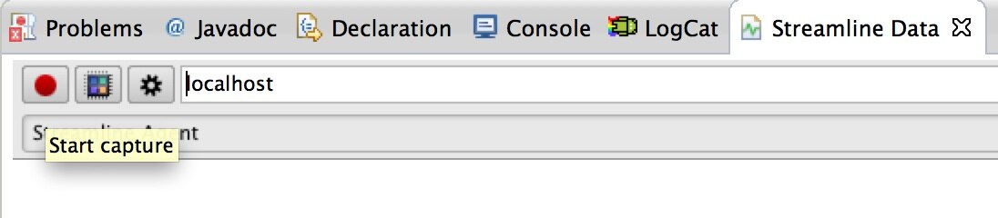

In the address section, enter “localhost” if you’re streaming the capture data over USB using adb to forward the TCP port. In the Program Images box select the shared library that you want to profile (add ELF image from workspace).
You can now use the red “Start Capture” button at any time.
