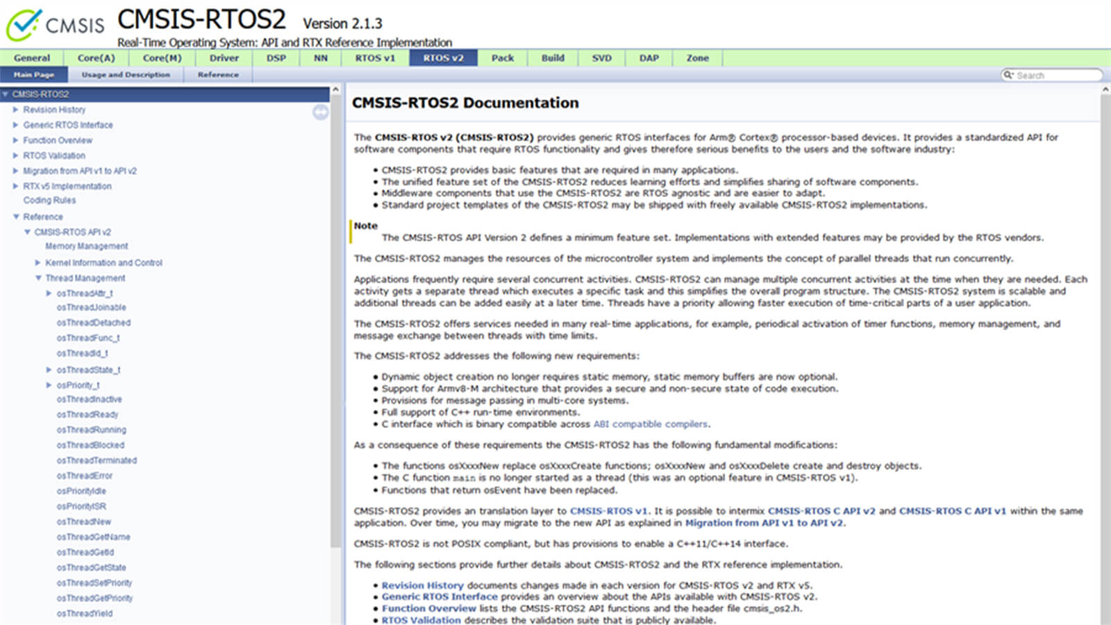

The patch has been released today and users of the CMSIS-RTOS v2 based Keil RTX5 need to be aware of the following:
  • The vulnerability is not present in the CMSIS-RTOS v2 API as such. It is part of the implementation that Keil RTX5 is providing.
  • The potential issue is present in an internal function of Keil RTX5 that is not intended to be used by software developers directly.
  • This function osRtxMemoryAlloc is used in the various object creation functions (such as osThreadNew) that are supposed to be used by the application developer.
  • The patch ensures that the object creation functions use osRtxMemoryAlloc in a way that the ‘size’ parameter is never a large value (>=0xFFFFFFF8U) and no wrap-around is possible.
