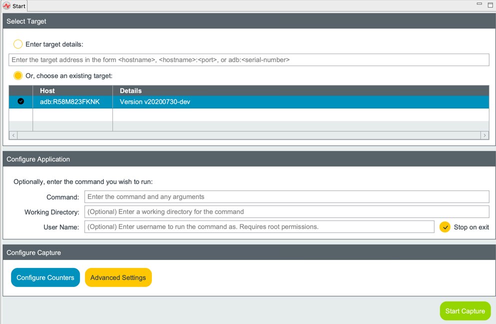

- Use the Start tab in Streamline to select your device. Select Or, choose an existing target, then select your device from the list.
- Before starting the capture, choose Configure Counters to choose a counter template.
