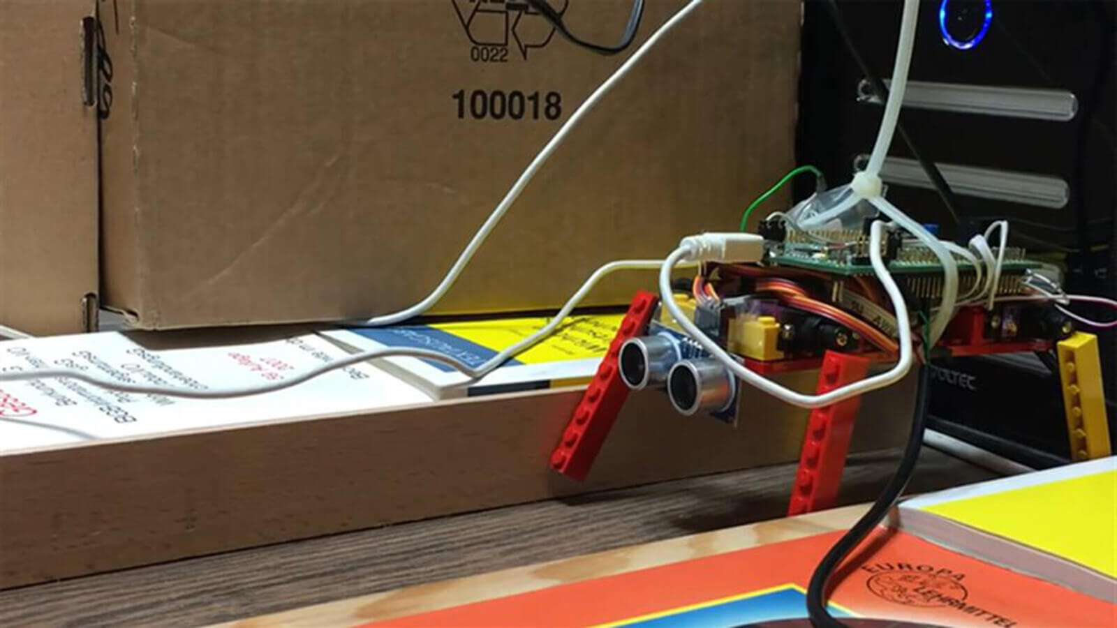

What would you do with a Cortex-M4, a motor or two, some lego and a few cable ties? Well, if you’re Sebastian Förster, an embedded systems developer based in Germany, the answer is a small, four-legged robot that you’d teach to walk using neural networks.
The robot – otherwise known as Scratchy – has four servomotors for legs, an ultrasonic capsule for distance measurement and is controlled by an STM32F407 Discovery board.

“The thesis I did for my master’s degree was about the suitability of applying machine learning to smaller, Cortex-M processors – looking at concrete examples of neural networks and running performance tests on them. As part of that, I ported the FANN neural network library to the Cortex-M4 and was looking for something less academic and more fun to try it out on. I wanted to work on something tangible, so I decided on a robot. As you can see, I didn’t put a lot of work into it – just connected a few Lego bricks to some motors and an STM32F4 developer board with enough flash and SRAM.
“The conclusion of my thesis – which is also clearly illustrated by my success with Scratchy – was that it is absolutely possible to run heavy machine learning algorithms on small, Cortex-M-based devices.”
Did you try to program the leg movements yourself?
“No, as far as I’m concerned, that’s what AI is for! Scratchy was constructed in a way that allowed me to train the forward and backward gaits independently, but I must admit that I was surprised that it worked without knee joints. I decided to use Q-learning because Deep Mind had had such success with their Atari Q-learner, and I was able to build on their work to I write the Q-learning agent. The FANN library is developed by others under LGPL; I simply ported it to the Cortex-M4."
