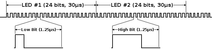

The WS2811 controller chips in each LED require a special 1-wire data format with precise timing. Data is always transmitted at 800 kbits/sec, where the width of each pulse indicates if it's a 0 or 1.
OctoWS2811
Each LED consumes the first 24 bits it receives, then begins passing all remaining data to the following LED. The first 24 pulse control the first LED, then the next 24 control the 2nd LED, and so on. A silent time of 50 us or greater marks the beginning of a new data frame.
OctoWS2811 is named "Octo" because it transmits 8 streams of these pulses simultaneously. Because each LED requires 30 microseconds, eight parallel outputs allows a very large LED array to update 8 times faster.  In this 4320 LED project, each of the 8 outputs controls 540 LEDs, which requires 16.2 ms, or approximately half of a 30 Hz video frame time.

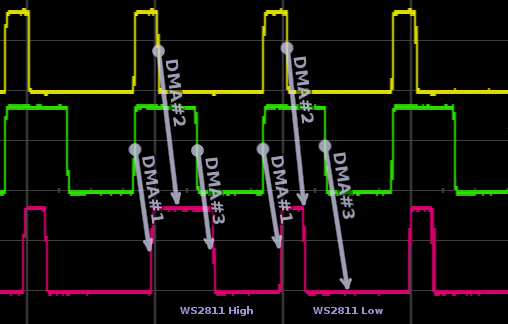

To achieve 8 outputs efficiently, OctoWS2811 uses the Kinetis eDMA engine. Two PWM waveforms are created, corresponding to the 0 and 1 pulse shapes. The waveform edges trigger DMA events, which copy data directly from RAM to the Kinetis GPIO register than controls 8 pins.
OctoWS2811_14
DMA#1 always copies an all 1s byte (0xFF), causing all 8 bits to high to start a new output pulse. DMA#2 copies a byte from OctoWS2811's display buffer, causing the LEDs to receive a different length pulse. DMA#3 copies an all 0s byte (0x00), causing the waveform to always go low, before the process repeats. This DMA-based data copying allows the Cortex-M4 CPU to remain almost completely unused, except for extra bus utilization, while the LEDs update.

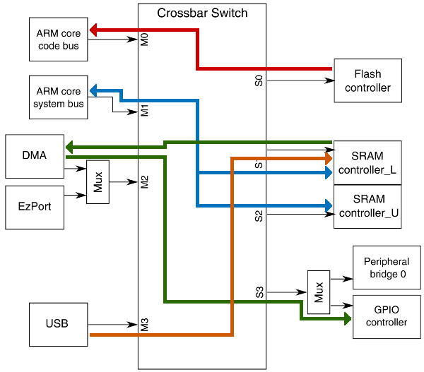

The Kinetis microcontrollers have a switched bus matrix and dual-bank RAM, which minimizes bus contention.
OctoWS2811_13 diagram
While the DMA controller is moving data from RAM to the GPIO register (the green path), the Cortex-M4 is able to simultaneously fetch code (the red path) and stack-based variables (the blue path).

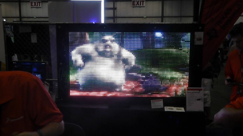

Finished LED display
