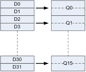

Armv7-A and AArch32 have 32 x 64-bit Neon registers (D0-D31). These registers can also be viewed as 16x128-bit registers (Q0-Q15). Each of the Q0-Q15 registers maps to a pair of D registers, as shown in the following figure.
Register mapping Q0-Q15 D registers

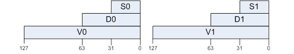

AArch64 by comparison, has 31 x 64-bit general purpose Arm registers and 1 special register having different names, depending on the context in which it is used. These registers can be viewed as either 31 x 64-bit registers (X0-X30) or as 31 x 32-bit registers (W0-W30).
AArch64 has 32 x 128-bit Neon registers (V0-V31). These registers can also be viewed as 32-bit Sn registers or 64-bit Dn registers.

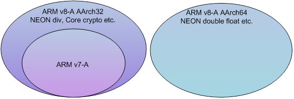

The following figure illustrates the relationship between Armv7-A, Armv8-A AArch32 and Armv8-A AArch64 instruction set.
The Armv8-A AArch32 instruction set consists of A32 (Arm instruction set, a 32-bit fixed length instruction set) and T32 (Thumb instruction set, a 16-bit fixed length instruction set; Thumb2 instruction set, 16 or 32-bit length instruction set). It is a superset of the Armv7-A instruction set, so that it retains the backwards compatibility necessary to run existing software. There are some additions to A32 and T32 to maintain alignment with the A64 instruction set, including Neon division, and the Cryptographic Extension instructions. Neon double precision floating point (IEEE compliance) is also supported.

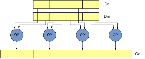

Neon data processing instructions are typically available in Normal, Long, Wide and Narrow variants.
  • Long (L): instructions operate on double-word vector operands and produce a quad-word vector result. The result elements are twice the width of the operands, and of the same type. Lengthening instructions are specified using an L appended to the instruction.
Neon data processing instruction long

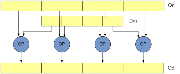

  • Wide (W): instructions operate on a double-word vector operand and a quad-word vector operand, producing a quad-word vector result. The result elements and the first operand are twice the width of the second operand elements. Widening instructions have a W appended to the instruction.
Neon data processing instruction wide

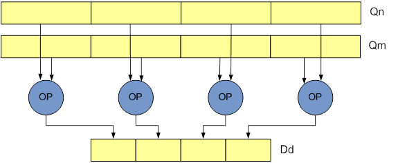

  • Narrow (N): instructions operate on quad-word vector operands, and produce a double-word vector result. The result elements are half the width of the operand elements. Narrowing instructions are specified using an N appended to the instruction.
Neon data processing instruction narrow
