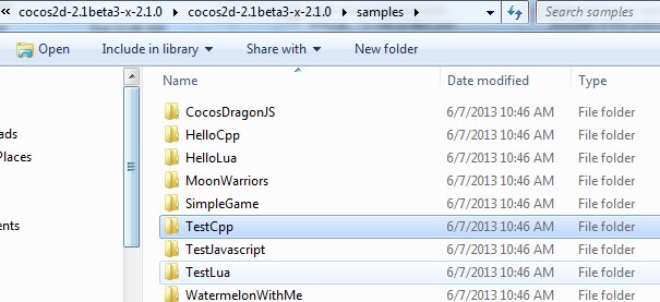

4.1 Build the benchmark application of Cocos2d-x
The benchmark app is stored in the source of Cocos2d-x, named as TestCpp under the “samples” directory, which is the official test suite developed by cocos2d-x team, and we will using those performance related test cases.
For how to build the TestCpp of Cocos2d-x for android platform, please follow the instructions README.md file under the “samples/Cpp/TestCpp/proj.android” directory.

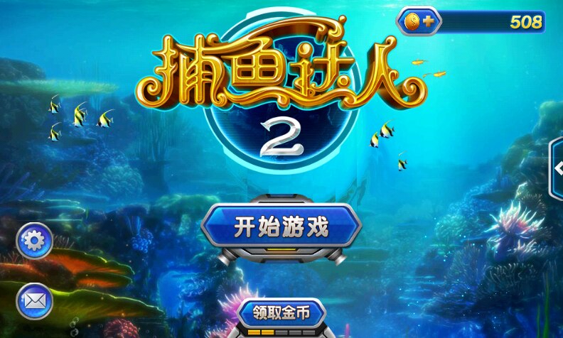

4.2 Build the Fishjoy2 application
Per the confidential reason, we can’t get the Fishjoy2 source code, so Fishjoy2 team help build it for us and provide us the apk and .so file with debug info.

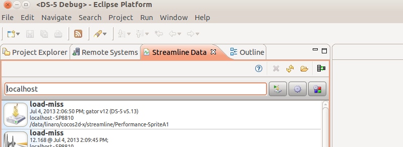

Start DS-5 tool from your PC and open the “Streamline Data” view as below chart show:

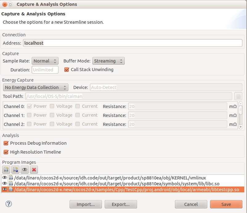

Click the Capture Options button (the gear icon) to open configuration window, and set the configurations as following:
  1. 1. Connection
    1. 1.1. Address: localhost
  2. 2. Capture:
    1. 2.1. Sample rate: Normal
    2. 2.2. Buffer mod: Streaming
    3. 2.3. Duration : Unlimited (leave it blank)
    4. 2.4. Call Stack Unwinding : checked
  3. 3. Energy Capture:
  4. 4. leave them as default
  5. 5. Analysis:
    1. 5.1. Process debug Information : checked
    2. 5.2. High Resolution Timeline : checked
  6. 6. Program images:
    1. 6.1. click the first icon to add all necessary symbol files that include the debug information for the library files, normally they are under directories like this:
<android-src-root>/out/target/product/<product>/symbols/system/lib/
  1. 6.2. add the symbol files of the TestCpp application,
<cocos2d-x-src-root>/samples/Cpp/TestCpp/proj.android/obj/local/armeabi/libtestcpp.so

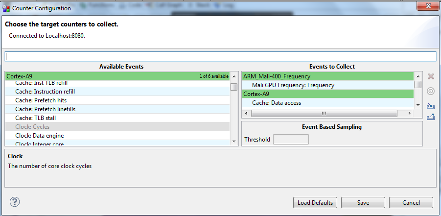

5.3 Select CPU/GPU related counters you want profiling
Open the counter configuration tab and select the target counters you would like to check and show in the streamline analysis report, left side is the available counters you can selected, and right side shows the counters you already selected.

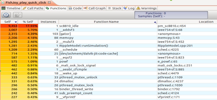

Click to the Functions View, you will see the CPU usage percentage of all the functions. And normally we should check those top CPU usage functions to see whether there are work as design or potential performance issues.
You can reference this link to get more detail information on how to utilize Streamline.

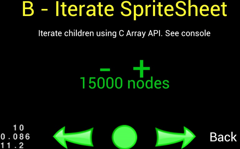

Start the TestCpp application on the test device and run the test case: PerformanceTest->PerformanceNodeChildrenTest->B Iterate SpriteSheet, click the + button to increase the nodes to 15000, we can see that the FPS is about 11.
Collect profiling data and analyzing it:

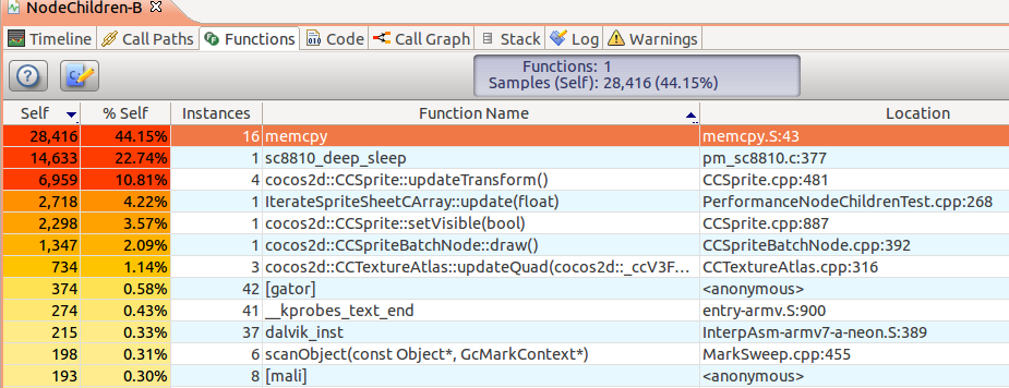

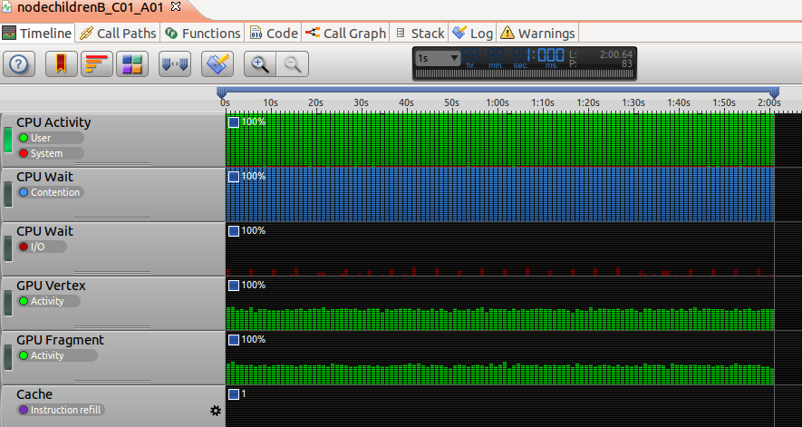

Collect profiling data about 10s, from the timeline view profiling report we can see that the CPU is busy, but considering that this case is mainly doing the process of iterating the array, it is almost in the indefinite loop, so the CPU in high percentage should be OK.

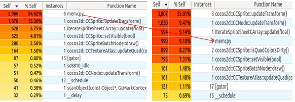

Then from the Functions view, we can see that the hotspot is the memcpy function which takes about 50% CPU time.
For this memcpy hotspot we checked:
  1. the memcpy method itself
  2. the code function who call the memcpy

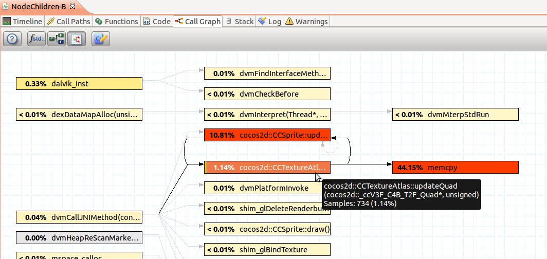

Go to Streamline “Call Graph” view we found it’s updateQuad method of CCTextureAtlas class who call memcpy continuously.

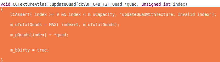

Dig into the source of updateQuad method
We find that there is a ”=” sentence to assign the big struct ccV3F_C4B_T2F, which is 96 Bytes. With the knowledge of android toolchain, we know this assignment will call the memcpy function at runtime.
After investigate the source and some discussion with cocos2d-x engine team, we believe it is possible to use element reference directly in the code where calls this updateQuad method.

  1. CPU time in functions tab(54.62%->9.10%)
The CPU time of memcpy function deduced from 54.62% to 9.10% after optimization
  1. FPS in screen(11.3 fps->17.2 fps)
The FPS increased from 11.3 to 17.2, performance increased about 70% for this specific case

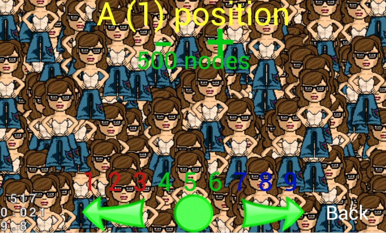

6.2 Profiling Story 2-- PerformanceTest Sprite A(1) case
Run the test case
Start the TestCpp application on the test device and run the test case: PerformanceTest->PerformanceSpriteTest->A(1) position, click the + button to increase the nodes to 500.

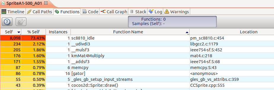

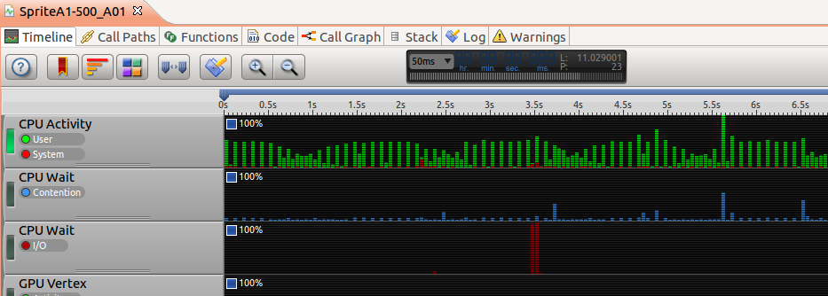

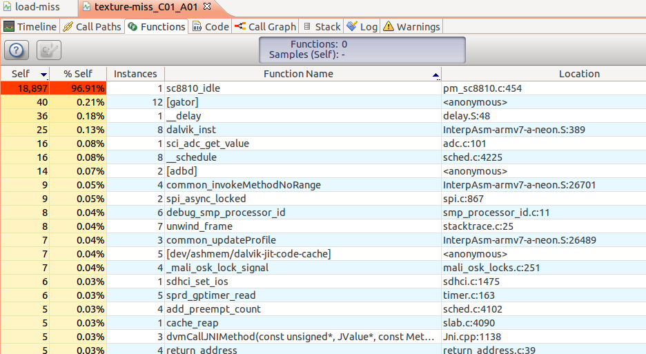

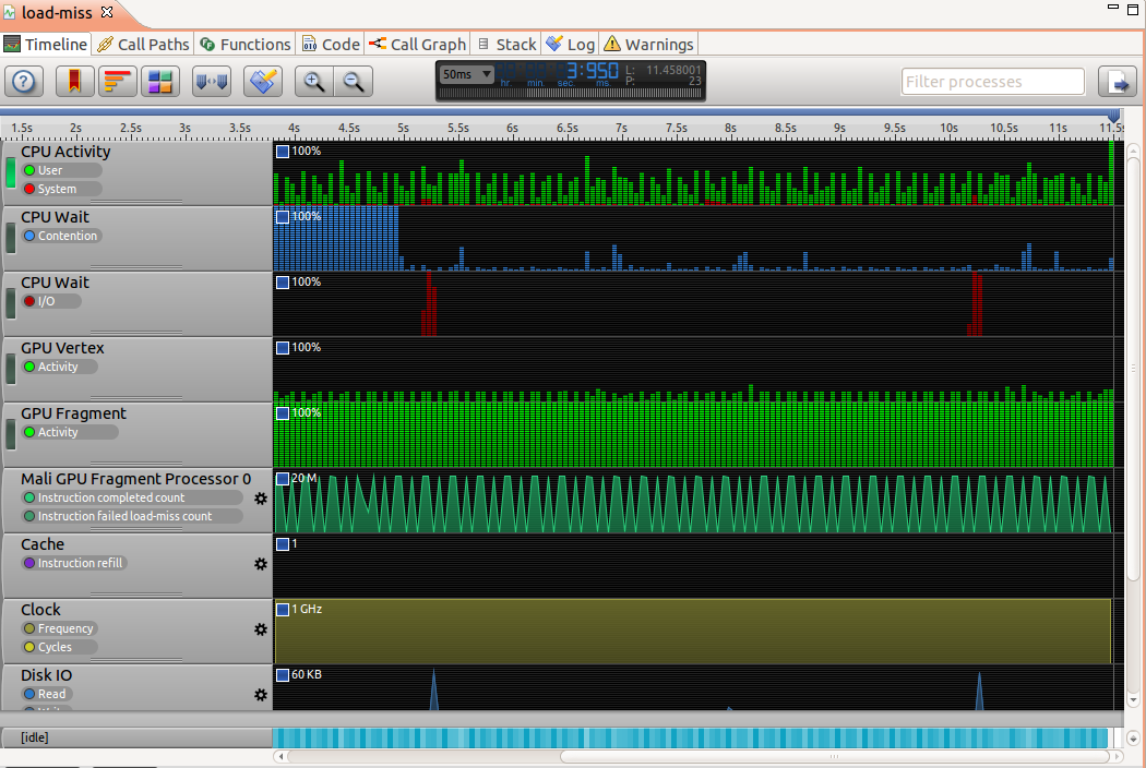

Collect profiling about 10s, from the Timeline view we found that so far the CPU is not too busy.
But from the Functions view, idle process(sc8810_idle) takes about 73.43% CPU time.
Based on the experience, we know which meaning the system should be busy, CPU is waiting for something to be completed, like the IO. And in this case, the main IO should be the GPU. So we need check about the GPU status with streamline. This needs the Mali support gator driver module.

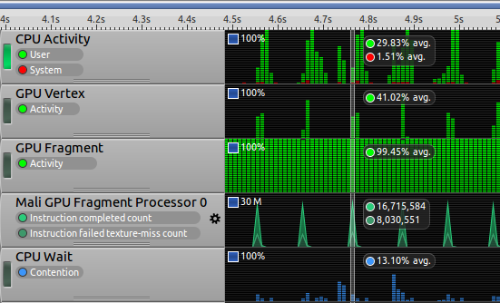

For this GPU hotspot we can check from two points based on experience:

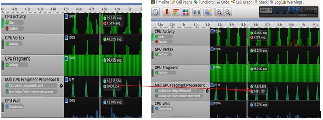

  1. Instruction failed texture-miss count

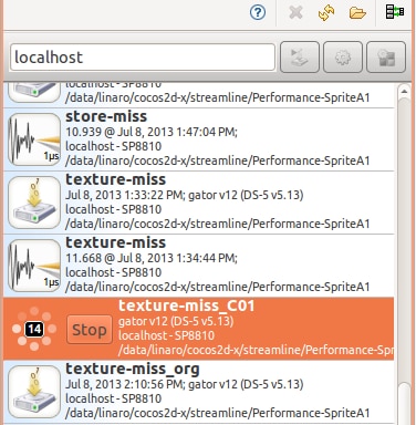

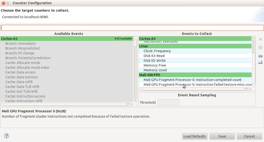

Open the Counter configuration window and add below two counters to the collection list, save and recapture streamline data
  • Mali GPU Fragment Processor 0: Instruction completed count
  • Mali GPU Fragment Processor 0: Instruction failed texture-miss count
Then we can see that the failed texture-miss count is about 8,030,551, meaning too many instructions are failled to load that texture during fragment shading.

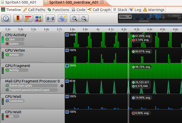

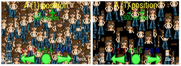

  1. The overdraw factor

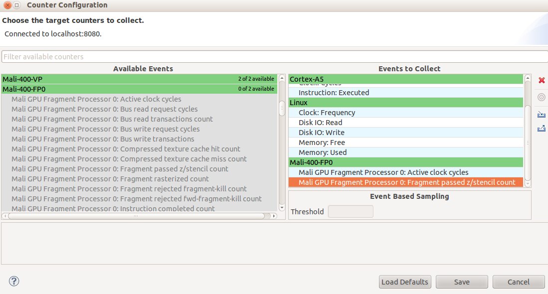

Open the Counter configuration window and add 2 more hardware counters and recapture streamline data
  • Mali GPU Fragment Processor 0: Active Clock Cycles
  • Mali GPU Fragment Processor 0: Fragment passed z/stencil
Then we can see that the passed z/stencil count is about 8,573,446
With the overdraw formula, overdraw is about 22.3, which is too high as the overdraw factor for a typical application should be around 3.
overdraw = "Fragments Passed Z/stencil count" / "Device Resolution"
                = 8573446/(800*480)
                = 22.3
The cache of the Mali300 of the device we used is only 8K, and it would be the main reason that causing the huge number of texture misses. Per GPU knowledge, using compressing textures technique would help to reduce this misses. Unfortunately, cocos2d-x engine didn’t support compressed texture, after some technical discussion between ARM’s GPU experts and coco2d-x developer team, they finally have ETC1 format supported with the latest engine.
To testing the performance impact with compression texture, we convert the .png file to ETC one and change below code from:
Normally, object drawing sequence will impact overdraw a lot, back->front is the worst case and front->back the best case. After checking with Cocos2d-x team, we was told that all objects have the same Z-order, unfortunately which cause highest overdraw as the worst-case “back->front”. That’s why streamline report show fragment shader cost a lot and fragment GPU is so busy.
Typical ways to reduce overdraw factor is have the app drawing its objects from front to back instead of back to front by having a Z sort at CPU side before submitting geometry to the GPU.
Cocos2d-x team agree with ARM’s proposal but still not support it since it might cause big architecture modification, they need evaluate the side effect. If your profiling report shows the same overdraw issue, please try ARM’s proposal above.

  1. Instruction failed texture-miss count (8,030,551->3,081,109, 61.6%)
The failed texture-miss count reduced from 8,030,551 to 3,081,109 after used the ETC1 format.
  1. FPS in screen(9.3 fps->12 fps 29%)
The FPS changed from 9.3 to 12.0, meaning performance increased about 30% with the ETC format supported.

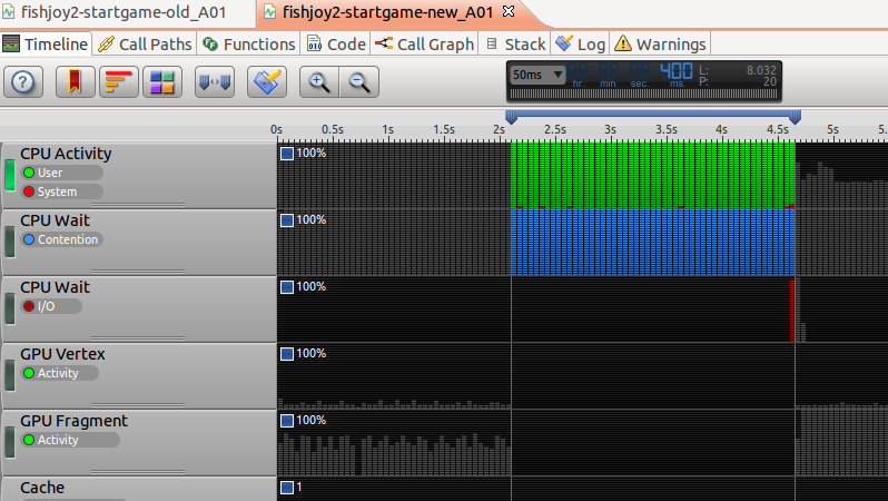

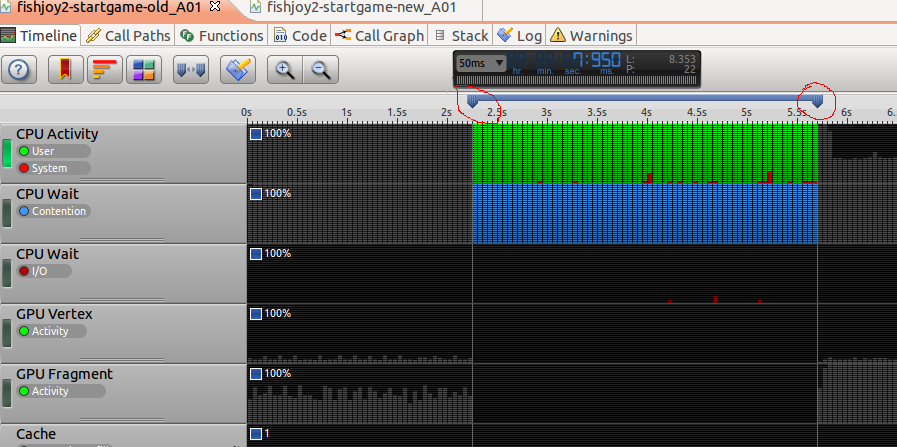

6.3 Profiling Story 3-- FishJoy2(Start Game)
Run the test case
Firstly, please make sure device connect to internet via wifi, and then start the Fishjoy2 app.

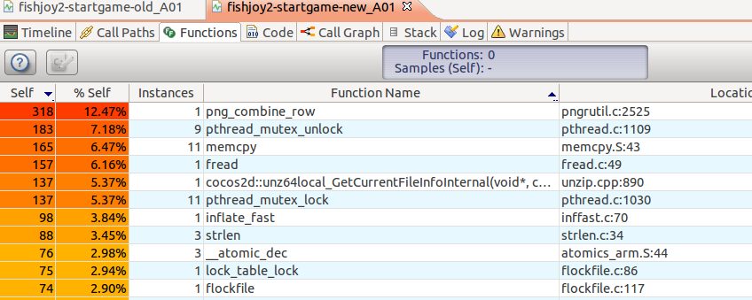

Starting streamline capture by click the “Start Catpure” button, and then click the START button to start playing the game, stopping streamline capture once displayed the scene selection window.
In the timeline view, drag the two blue icons of the time ruler to cover the data for the start operation only. We can see that the START operation cost about 3.5s(2.2->5.7), and the CPU is busy, GPU is idle.

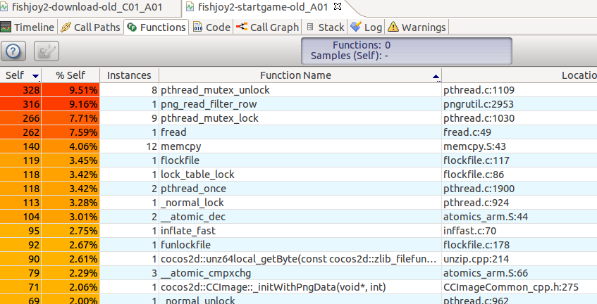

In the Functions view, we can see that the phread_mutex_unclock and pthread_mutex_lock takes 17.22% CPU time(9.51% + 7.71%)
Find the solutions:
After talked with the FishJoy2 team, they confirmed that it’s not expected for the pthread operation to take so much CPU time, they do find some defect of the source code, and fix it.
Optimization result:
  1. 1.    Start time(3.5s->2.5s, 28.6%)
After get the updated APK and recapture streamline report, you will see the start operation time reduced from 3.5s to 2.5s(2.1->4.6)
  1. 2.    CPU time(17.22%->12.55%, 27.1%)
And the function view show CPU occupancy rate of pthread operation reduced from 17.22% to 12.55%(7.18% + 5.37%)

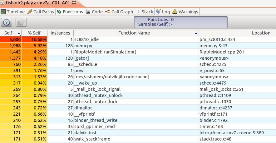

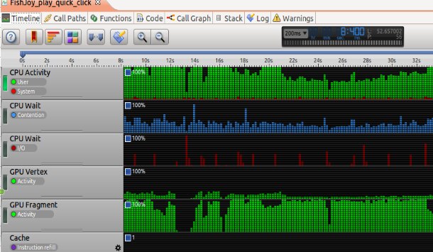

6.4 Profiling Story 4-- FishJoy2(Quick click to play the game)
Run the test case
Start the FishJoy2 Application, and play the ame about one minute
Capture the streamline data about 30s, you will see the Timeview profiling report show fragment GPU is very busy.
The Functions view show the idle process takes up the highest CPU time. And we can also see that there are many float related system calls takes higher CPU time, eg: the _addsf3/mulsf3/eqsf2
Find the solutions:
For the idle process and the high usage of GPU processor, we already know that this is the same problem with the Profiling Story 2 we met.
For many float related operation system calls taking higher CPU time, which is abnormal since ARM already optimized this kind of functionalities, after some discussion with Fishjoy2 team, we finally find that this game is compiled with the armeabi ABI, not with the armv7a ABI. We suggest fishjoy2 team recompile apk with armeabi-v7a option enabled as below code show:
$ cat samples/Cpp/TestCpp/proj.android/jni/Application.mk
APP_STL := gnustl_static
APP_CPPFLAGS := -frtti -DCC_ENABLE_CHIPMUNK_INTEGRATION=1 -DCOCOS2D_DEBUG=1 -std=c++11
NDK_TOOLCHAIN_VERSION=4.7
APP_ABI := armeabi-v7a
After compiled the game with armv7a ABI, we can see that the float related operations disappeared in the higher CPU time occupancy list.
