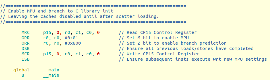

A good place to get the details of hardware programming is in the DS-5 examples/ directory. The file Bare-metal_examples_ARMv7.zip contains example startup code for many different CPUs. Extracting the file and looking at the code for each CPU provides insight into how to make sure the maximum performance is realized. The file startup_Cortex-R8/startup.s shows how to set the Z bit to enable branch prediction.
The Z bit is located in the system control register, SCTLR, and is bit 11.
The example code to enable branch prediction is below.

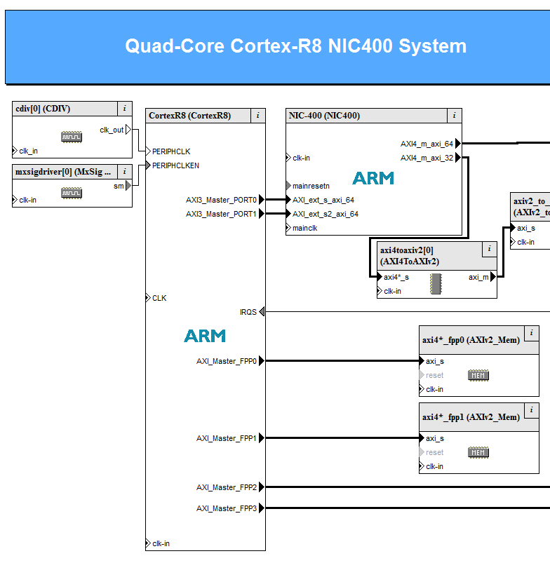

A Cortex-R8 quad-core CPAK was used to experiment with branch prediction for the CPU. It can be run on either Windows or Linux using SoC Designer. For more details of this and other CPAKs visit ARM System Exchange.

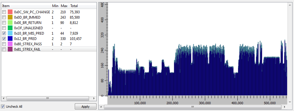

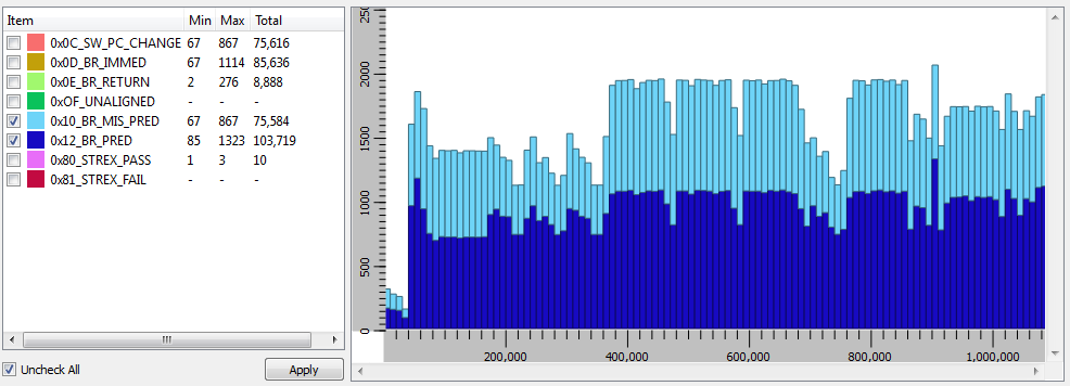

Below are two views of the branch prediction PMU events. The first is for CoreMark with branch predication off and the second is the same CoreMark with branch prediction on. The mis-predicts are very large without setting the Z-bit to a 1 and very low when the Z-bit is set to 1. The numbers in the "Total" column represent the total number of events for the entire simulation. Click on the graphs to get a better view.
