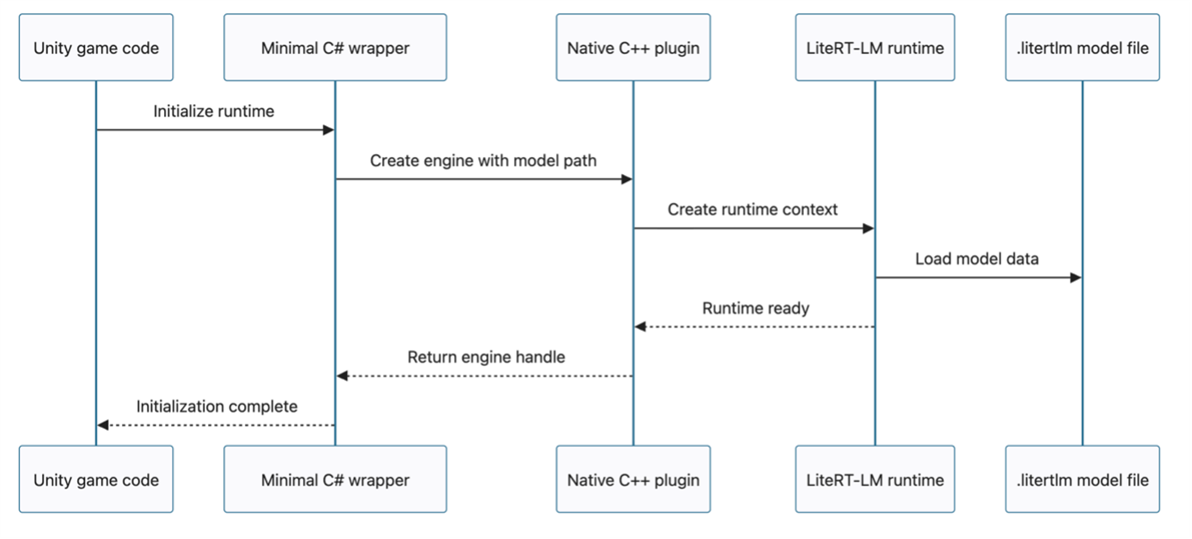

The next step was to benchmark the runtimes inside Unity. This measured whether engine integration introduced meaningful overhead through plugin calls, scheduling, or streaming behavior. Existing Unity inference plugins were available for llama.cpp, through LlamaSharp and LLMUnity. GemmaUnity provided a plugin for gemma.cpp. LiteRT-LM did not yet have an equivalent Unity integration, so a custom lightweight plugin was developed around the native runtime.
Sequence diagram illustrating how Unity initializes a LiteRT-LM runtime through a C# wrapper, native C++ plugin, and .litertlm model file.
Figure 2. LiteRT-LM plugin architecture for initialization

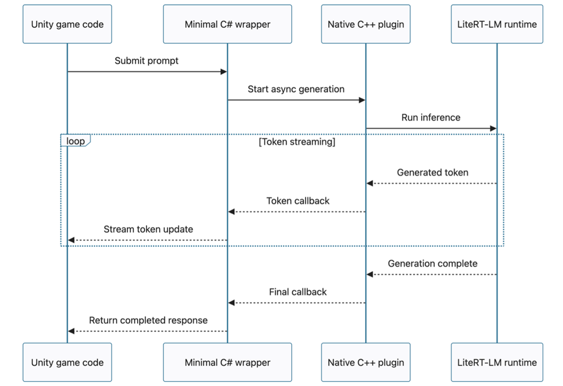

Sequence diagram illustrating asynchronous token streaming and response generation between Unity, a native C++ plugin, and the LiteRT-LM runtime.
Figure 3. LiteRT-LM plugin architecture for inference
The plugin was implemented in native C++ rather than Kotlin to keep the inference path close to where the Unity game code runs on Android. With IL2CPP, Unity scripts are compiled ahead of time into native code, and Unity native plugins can be called directly from that layer. Routing inference through Kotlin bindings would add an extra Android/JNI boundary between the game and the native LiteRT-LM runtime. Keeping the plugin in C++ avoids unnecessary layer transitions and keeps the integration lightweight. Once the plugin was created, the runtimes were benchmarked inside Unity.

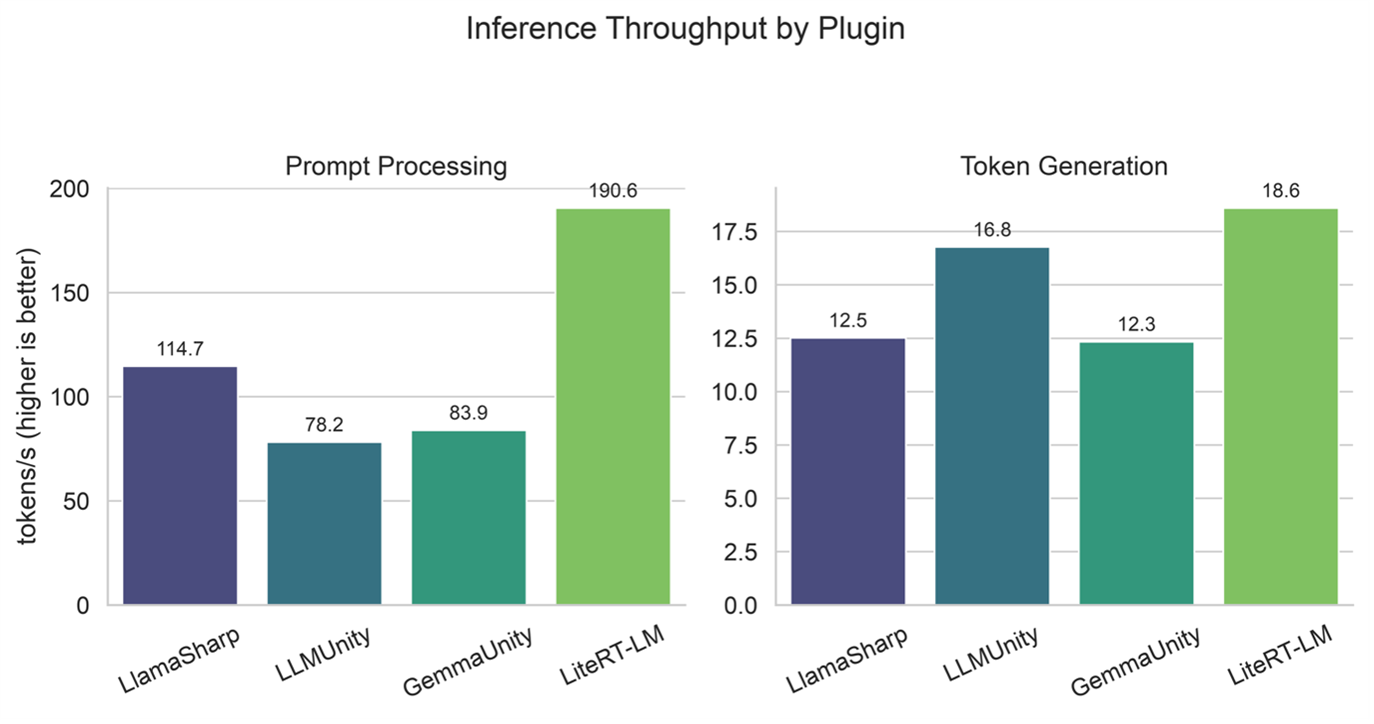

Inference throughput comparison of Unity plugins showing LiteRT-LM achieving the highest prompt-processing and token-generation performance.
Figure 4. Performance of the different runtimes within Unity
LiteRT-LM achieved the highest throughput for both prompt processing and token generation. Conversational gameplay depends on both the delay before a response begins and the speed at which the response is produced, this made LiteRT-LM the most suitable runtime for the final implementation.

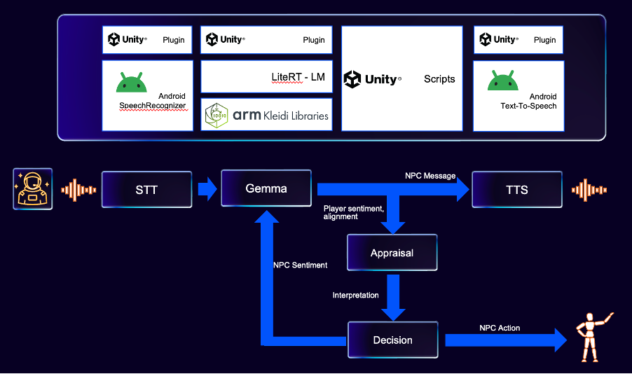

The full pipeline
System architecture for First Contact, showing speech-to-text, Gemma-based language generation, appraisal, decision-making, and text-to-speech integrated with Unity and Android.
Figure 5.  Application Pipeline
The demo takes place on a human space outpost that is unexpectedly visited by an alien spacecraft, arriving without warning and revealing nothing about its intentions.
The alien is designed to remain enigmatic throughout the interaction. Its responses gradually reveal information about itself, encouraging the player to continue engaging with the character out of curiosity about who it is, why it has arrived, and what it wants.
The interaction extends beyond simply exchanging information. In addition to generating dialogue, the alien interprets sentiment and alignment in the player's responses. This enables it to react differently to cooperative, neutral, hostile, or silent behavior, causing the encounter to evolve based on what the player says.
The player must navigate the interaction while balancing 2 objectives: learning more about the visitor and protecting the base. The encounter can lead to several different endings, such as being invited to the stars by the alien, getting the human outpost destroyed, or running out of time as the sun sets.
The core gameplay loop sends the player's speech through a pipeline that turns spoken input into an alien response and feeds the parsed result back into the game state.
The process starts with speech-to-text: when the player speaks, Android’s built in speech-to-text API transcribes the audio.
Once transcription is complete, the prompt is sent to the LLM alongside game-state data such as the alien's current sentiment and previous topic.
The LLM uses this context to generate an in-character reply and produce structured labels for the player's alignment and sentiment. Lightweight gameplay state machines then use these labels to update the alien’s sentiment and trigger the appropriate response in the encounter.
The NPC response is then sent to the text-to-speech module, which also uses Android's built-in API.
A key aspect of this pipeline is that the heaviest AI and speech components operate outside the game engine. Speech recognition, LLM inference, and speech synthesis are performed in the Android-native layer, while the game engine consumes the resulting text and labels to update the encounter. This separation keeps the integration lightweight whilst also enabling the AI stack to evolve independently of the engine itself.

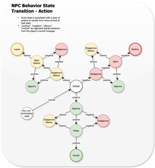

Appraisal: Interpreting LLM outputs
The LLM does not directly decide what the alien does. Instead, the structured output is passed to the appraisal layer. This layer reads the player's sentiment and alignment labels and converts them into a compact gameplay signal: positive, neutral, negative, or silence.
Hostile language or low alignment is appraised negatively, while respectful, high-alignment responses are appraised positively. Medium-alignment responses remain neutral, and missing or silent input is handled separately. This gives the game a stable interpretation of the player's intent without asking the model to control the encounter directly.

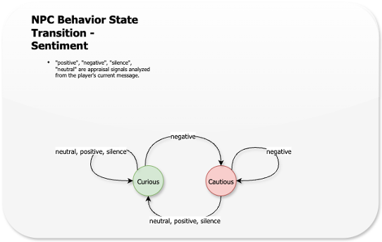

Decision: Turning appraisal into actions
The decision layer then combines the appraisal signal with the current encounter state. Lightweight gameplay state machines use this information to update the alien's sentiment and select an appropriate response. This keeps narrative consequences predictable while still enabling natural language to shape the encounter.
Repeated negative appraisals can push the alien toward cautious or defensive behaviors, such as warnings, whereas repeated positive appraisals can sustain curiosity and lead toward more cooperative outcomes. The updated sentiment is also fed back into later prompts, which helps the conversation feel connected rather than reset each turn.
NPC behavior state machine showing how positive, negative, neutral, and silence appraisals drive transitions between approval, warning, and terminal actions. NPC sentiment state machine showing transitions between Curious and Cautious states based on positive, neutral, negative, and silence appraisal signals.
Figures 7 and 8. Alien behavior state
