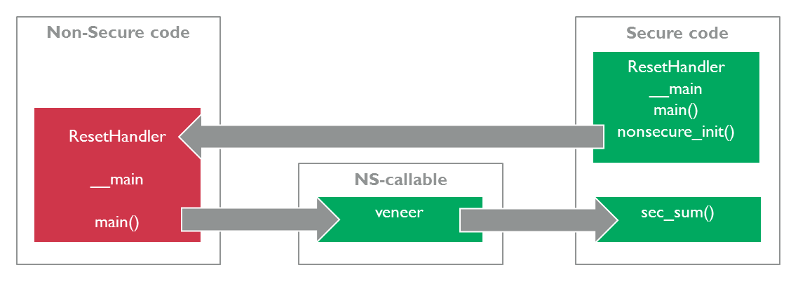

Startup and Secure calls
Confused yet?  Let's walk through a run now that everything is set-up.
Starting at reset, we go through the following sequence of events.
  • The stack pointer is set from the Secure vector table and branch to the reset handler.
  • From there, the system is initialised first, including set-up of the SAU, followed by a branch to __main, the entry point of the (Secure) C library.
  • After initialising itself, the C library calls main() which goes on to call nonsecure_init() which puts us in NS state.
  • In NS state, it is the same sequence of events going from the reset handler through __main to main().
  • Once sec_sum() is called, it passes through the NS-callable veneer to return to Secure state momentarily before NS printf() outputs the result.
